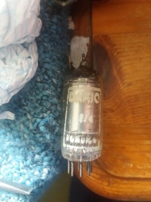

I have an old Ripmax Pathfinder that I'd like to get working. It looks to be an early type, with a single valve in the transmitter, which, unfortunately, is unreadable. I enclose a pic. It looks like DARIC 2/4 - but if anyone knows better what type it is...?
I would also like to know what voltage to try for both HT and LT. The component count inside is minimal - just three caps, a resistor, a valve and a coil. The steel box has two pushbutton switches on it which seem to control HT and LT respectively - but, oddly, they are not latching switches. So to radiate you seem to need to hold both down - a strange control interface!

Wow - they are more common than I thought!
Quite how the Tx is meant to be used escapes me, though. It seems to be designed to be turned off for most of the time, then when you want to turn the LT is activated warms up, and then you can key the HT. After that you shut it down again until the next turn...?
Posts: 1254
Re: More old bits and pieces...
Dodgy Geezer wrote: 01 Jul 2021, 22:16 It seems to be designed to be turned off for most of the time, then when you want to turn the LT is activated warms up, and then you can key the HT. After that you shut it down again until the next turn...?
That's correct, it was intended to extend the life of the LT heater battery. As mentioned the left hand button was called the "economy button". Back then most S/C models were really "affected free flighters" and didn't need much control input. Keeping it in the same field was considered a successful flight.

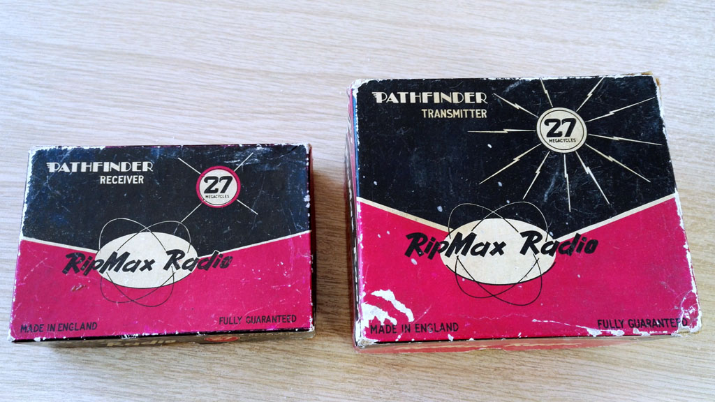

It looks like a growing number of us have a Ripmax Pathfinder MK1, it's nearly enough for an owners club!
Once my transmitters come out of storage, I'll scan the instructions for the transmitter and receiver, but in the meantime here are some adverts and a trade review from Aeromodeller, don't you just love the display stand for the receiver, I'd love to find one of those.
