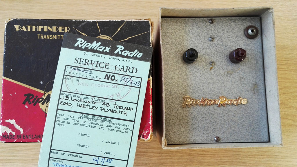

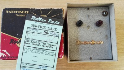

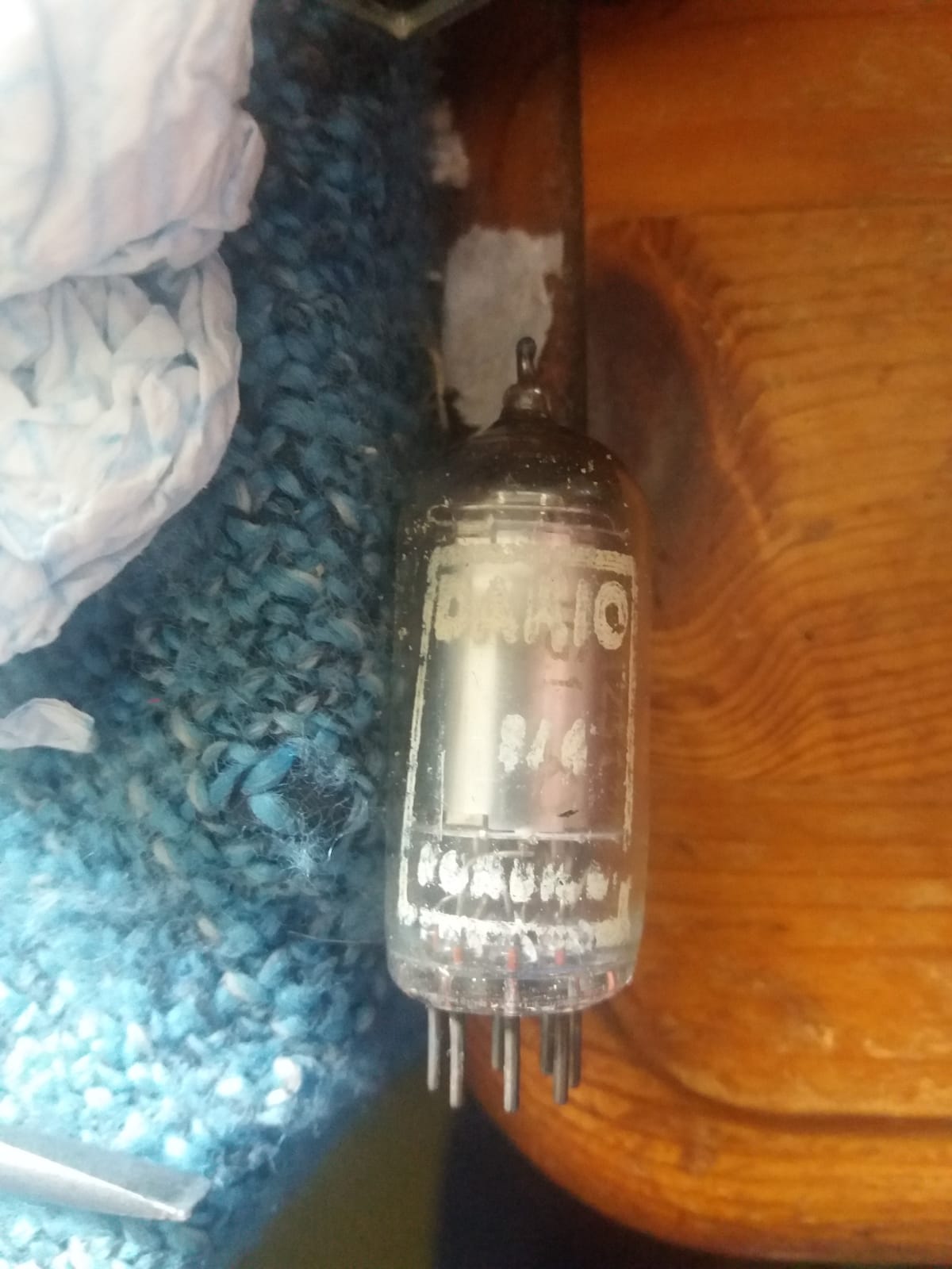

I have an old Ripmax Pathfinder that I'd like to get working. It looks to be an early type, with a single valve in the transmitter, which, unfortunately, is unreadable. I enclose a pic. It looks like DARIC 2/4 - but if anyone knows better what type it is...?
I would also like to know what voltage to try for both HT and LT. The component count inside is minimal - just three caps, a resistor, a valve and a coil. The steel box has two pushbutton switches on it which seem to control HT and LT respectively - but, oddly, they are not latching switches. So to radiate you seem to need to hold both down - a strange control interface!
The Rx is completely sealed in an opaque plastic box, with no way in. It has an aerial, and a 7-pin valve plug. Two pairs of the pins have a low resistance between them, 3-4 ohms, and the others show open circuit. If anyone has any ideas about this I would appreciate them - I don't really want to break into the box which is in good condition...
The set came with a 'control box', which is a mechanical pulser. I have got that working - it uses an old Ever-Ready T10 motor, and is intended to connect to the HT of a transmitter. The two buttons on it give you either full connection of nil connection, while not depressing either would give you a pulsed output from the Tx - this would provide a progressive control for a boat rudder (though the instructions talk about 'proportional'!
I can send further pics if anyone's interested...

Wow - they are more common than I thought!
Quite how the Tx is meant to be used escapes me, though. It seems to be designed to be turned off for most of the time, then when you want to turn the LT is activated warms up, and then you can key the HT. After that you shut it down again until the next turn...?
