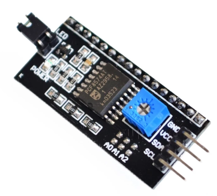

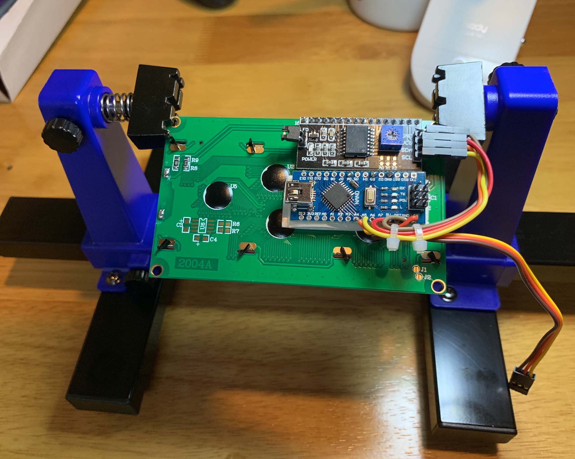

I’ve just built this tester using an i2c 20x4 lcd display. It’s identical to a normal 20x4 display apart from it only uses 4 wires instead of the usual 16, plus the contrast pot is built in. Makes this project much easier to wire up. You can also turn the backlight on or off in the software. May be of some use that feature, possibly as a battery saving system.
Here is a photo of the display working. Not very neat as it was just a quick wire up job to test. Obviously this can be neatened right up.
I had to change the lcd library in the sketch for an i2c version.

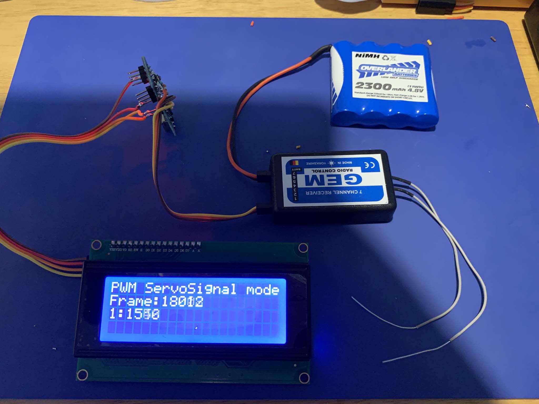

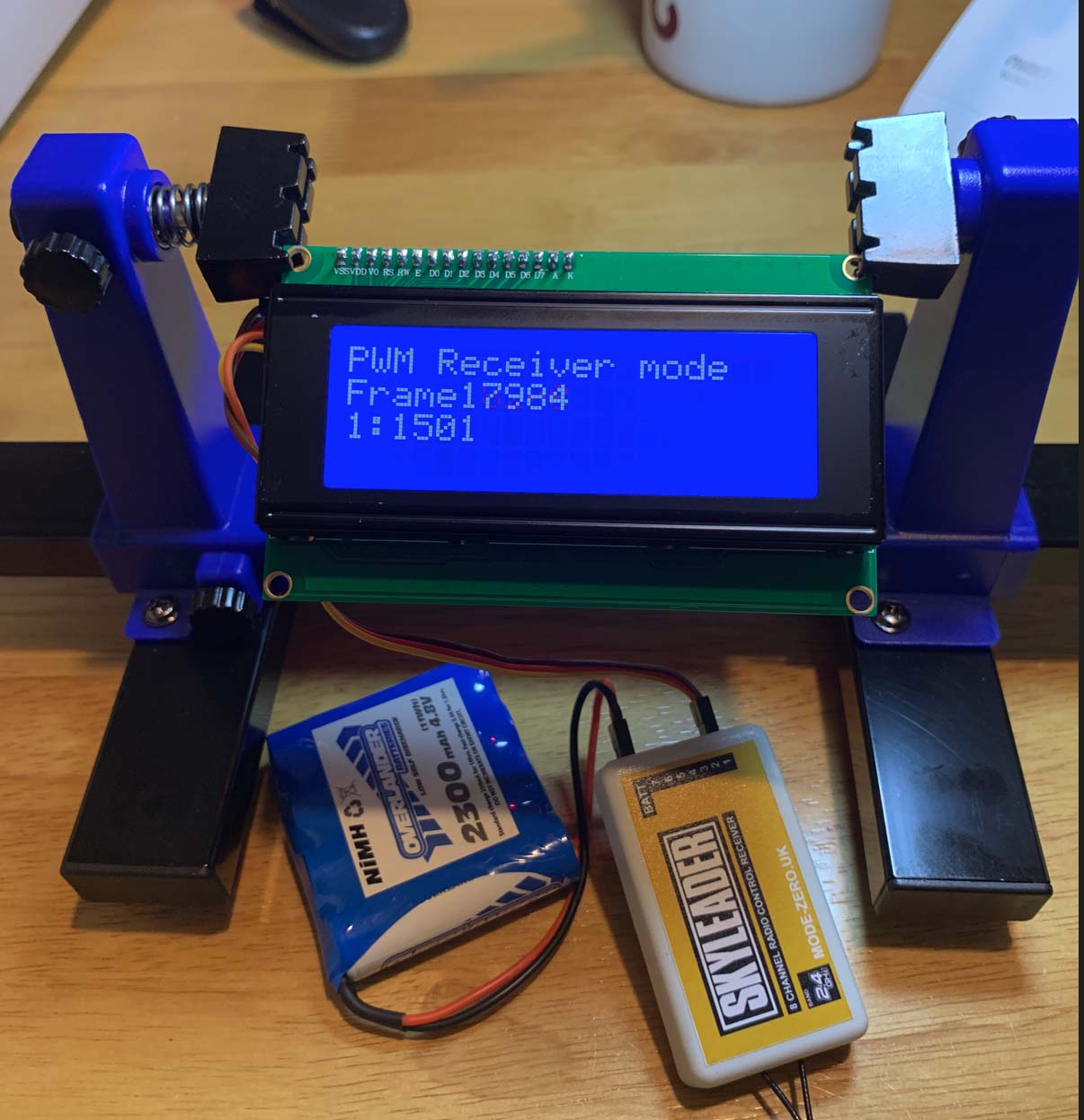

Re: PPM & PWM Tester/Analyser
Neatened up the i2c ppm tester, looks a bit better.

I never bother using the servo outputs so they have been omitted.
Mine is self powered so it runs from the encoder or RX battery.
Great little project, and very useful, Thanks Phil :D
