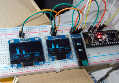

Ummmmmm.... how does that work Martin? How come the two left-most screens display an output without any connection to data or clock? Is that a really good photoshop job, some whacky parasitic crosstalk or some devious cabling under the breadboard?

Phil_G wrote: 28 Jan 2023, 10:26 For the photo Martin simply moved the yellow & white clock and data connections along the displays, to save wiring it 3 times :)
Thats why the 3 DSM2 plots differ slightly, the displays were clocked a few seconds apart after moving the connections and resetting the RF-Nano.
As long as power remains the display retains the screen contents without clock & data, its a static device ;)
Phew!.. thanks for the explanation Phil......I thought I was going to have to re-evaluate my understanding of breadboard construction there......
