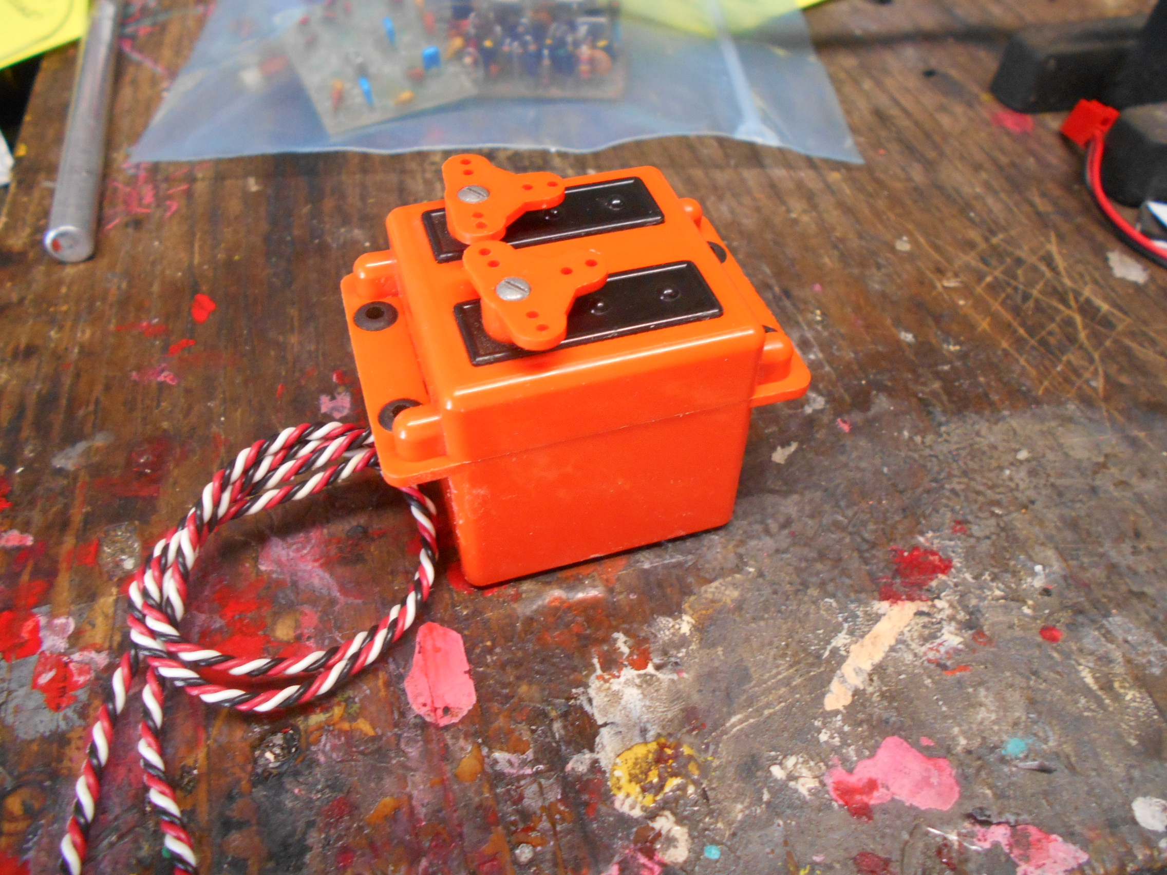

Awesome work Tobe. I'll have to order some from you in orange to duplicate the RS Systems 2 servo brick as used in the RTF Hobie Hawks!

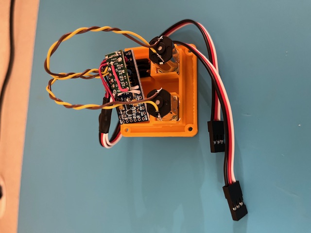

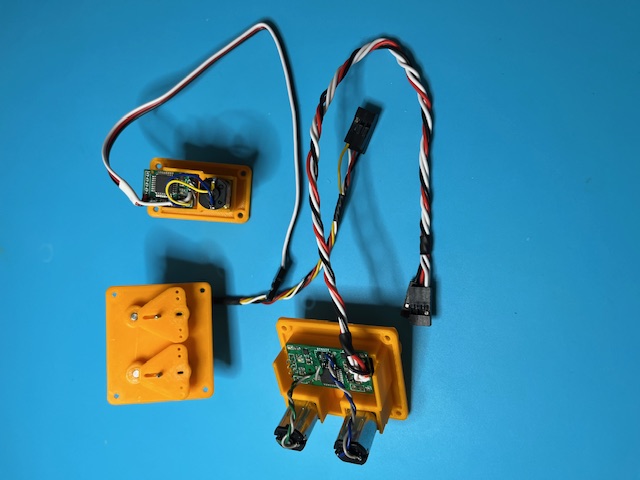

- Posts: 29
- Joined: 14 Feb 2022, 17:24
Re: The ProPo project, a DIY proportional servo
Hi Tobe:
I finally got caught up on my 3D printing and printed some ABS ProPo Servo parts for the Boards that you sent me. Thanks again for the help with the boards and MiniCore programing. See attached proto of a few of the completed ProPo's. Fun Project!
Many thanks,
Many thanks,

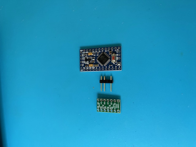

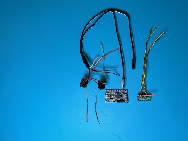

- Posts: 29
I thought I would post a few photos of a Propo with a DRV8835 mounted on top of an Arduino Pro-Mini. Pins were reassigned in the Sketch to allow 3 of the 4 PH/EN pins to line up. Thanks again to Tobe for his guidance.
