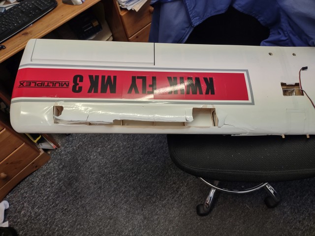

Another fine day on Saturday, so took the KwikFly up to get some more stick-time and explore its abilities.

The second flight was much more interesting! After a couple of minutes in the air, I became aware of a loud crackling noise that seemed to be coming from the model! My first thought was fire, as it sounded just like a bonfire!
I immediately throttled back for an emergency landing. It wasn't until the last few moments before touchdown that I became aware of something amiss with the upper surface of the starboard wing!
Due to the circuit direction, and attitude of the model, this had not been visible before.
On landing, I discovered that the covering on that wing had peeled back from the leading edge, right back to the main spar!
Although not visible in the picture, it actually extends from the wing root almost to the tip! Luckily, I didn't slow it up too much on the approach, as I think the stall characteristics could have been quite interesting! In the event, the landing was totally unexciting - a tribute to the designer!
I hope to get the wing LE recovered today - with plenty of overlap! I'll also be inspecting the rest of the covering closely!
Prior to the failure, there was no indication of any issues with the covering. Quite why it suddenly failed is a mystery. As I say, a very lucky escape!

I always thought the Kwik Fly 3 had a D-box sheeted LE Pete?
...though I had an Ugly Stik with an unsheeted wing that was really strong and survived for many years...
it had a slide-on nose-block and spent most of its time sloping - I also recall seeing a Kwik Fly on the slopes (Ron Donahue?) way before Squire Kay

I thought it did too, until I got hold of this one!
This seems to be built from a Graupner kit - or it may have been an ARTF. The build quality is excellent, though I would have done the electric conversion a bit differently. Its a pig to change the batteries!
Maybe the original KwikFly and/or KwikFly2 had a box section LE? The model feels quite light. Once airborne, it flies superbly and requires very little power. I need to investigate the yaw on take-off and the slight screwing on loops. Maybe it needs a bit of side-thrust? Its also possible that the u/c is a bit out of alignment, though it runs straight enough on my (flat!) garage roof.

My plan-built version does have a sheeted D Box

Yes, that looks a lot more robust! The Graupner one feels very light, which is good in one sense, but it is a bit of a floater when landing - and since Devon is nearly all hills, we quite often end up landing down the slope! Not so good!
Also, most of our fields are farmland, so hardly bowling green level, and a really solid undercarriage mount is a necessity! Tail-draggers definitely preferred!
It didn't take long to repair mine. I had some left over white Oracover, which is what I suspect it was covered in originally. In any case, it was a perfect match and was flying again by the week-end.
