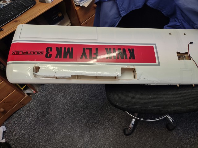

The second flight was much more interesting! After a couple of minutes in the air, I became aware of a loud crackling noise that seemed to be coming from the model! My first thought was fire, as it sounded just like a bonfire!
I immediately throttled back for an emergency landing. It wasn't until the last few moments before touchdown that I became aware of something amiss with the upper surface of the starboard wing!
Due to the circuit direction, and attitude of the model, this had not been visible before.
On landing, I discovered that the covering on that wing had peeled back from the leading edge, right back to the main spar!
Although not visible in the picture, it actually extends from the wing root almost to the tip! Luckily, I didn't slow it up too much on the approach, as I think the stall characteristics could have been quite interesting! In the event, the landing was totally unexciting - a tribute to the designer!
I hope to get the wing LE recovered today - with plenty of overlap! I'll also be inspecting the rest of the covering closely!
Prior to the failure, there was no indication of any issues with the covering. Quite why it suddenly failed is a mystery. As I say, a very lucky escape!
