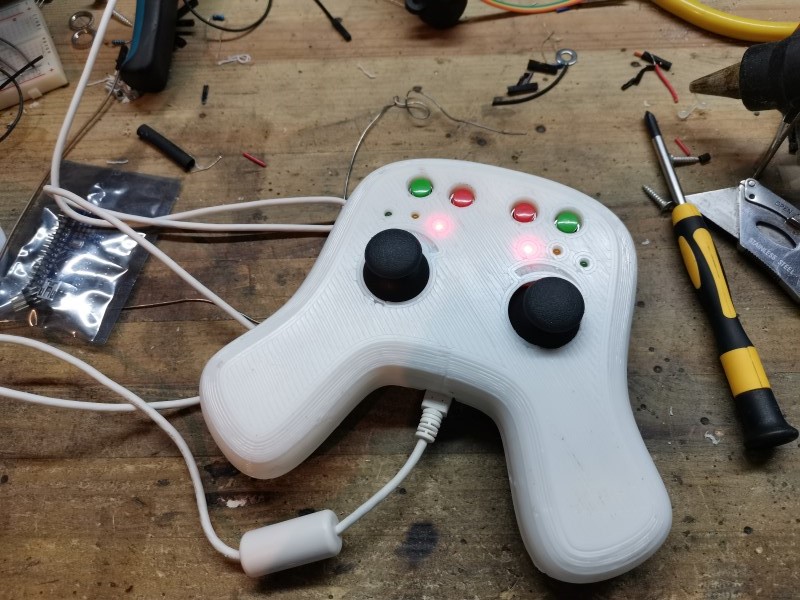

Looks cute! I dont have a 3D printer nor the artistry to create these things so I'm always in awe of those who do
Bill's Codamac, the one that needed a channel adding also used a PS gimbal: viewtopic.php?f=27&t=458
I also tried Playstation gimbals but found they were a bit too coarse for me, and needed a significant deadband for centring:
Eg the Micro-2:
viewtopic.php?f=27&t=777&p=6208
I have flown it a few times but much prefer a conventional stick like the Mini-2:
viewtopic.php?f=27&t=650&p=4964
This is the transmitter that lives in a RUB box in my van with a Lidl Glider & a Uke (flown by Mike_K and played by Pete_C respectively!)
Eg the Micro-2:
