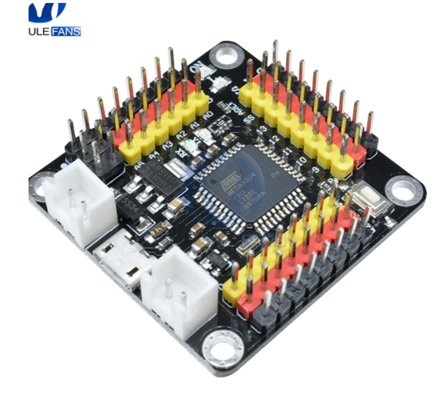

As an aside, I have one of the ATMega32U4 Strong boards -
I guess another downside to this board is the price being 50% more than the 328p strong board but I do just happen to have one.
The same quick mod to provide input voltage to the RF module by removing the 3v3 regulator and strapping the Vin to the Vout and away we go (I think). I'm looking to fit it all inside a computer joypad type case I have for a CNC pendant with the flysky RM003 tx module sticking out the back but it needs a bit of work to make it wider. I do wish people would upload their designs in a modifiable format and not an STL if it is for general release.
ModuleFans https://www.aliexpress.com/item/32867119179.html seems to stock the range
It flashes the firmware fine and the only drawback that I can see on the face of it is the lack of A6 and A7 being broken out to a header. I think a quick mod to the firmware to set rates = 0 and expo = 0 so the firmware never actually interrogates the analogue input pins will remove the problem of the input being left floating will allow this boards use (providing rates and expo isn't a thing for you!)Does anyone have a few spare DIY-More boards please?

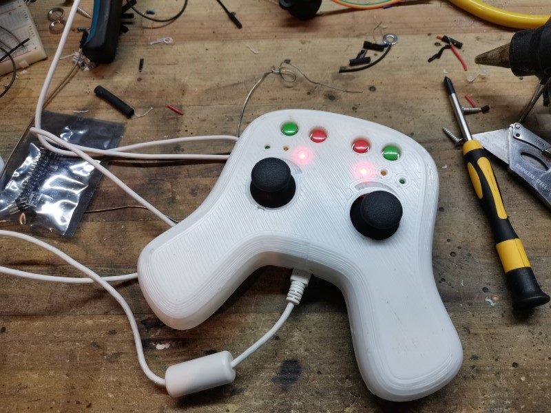

Looks cute! I dont have a 3D printer nor the artistry to create these things so I'm always in awe of those who do
