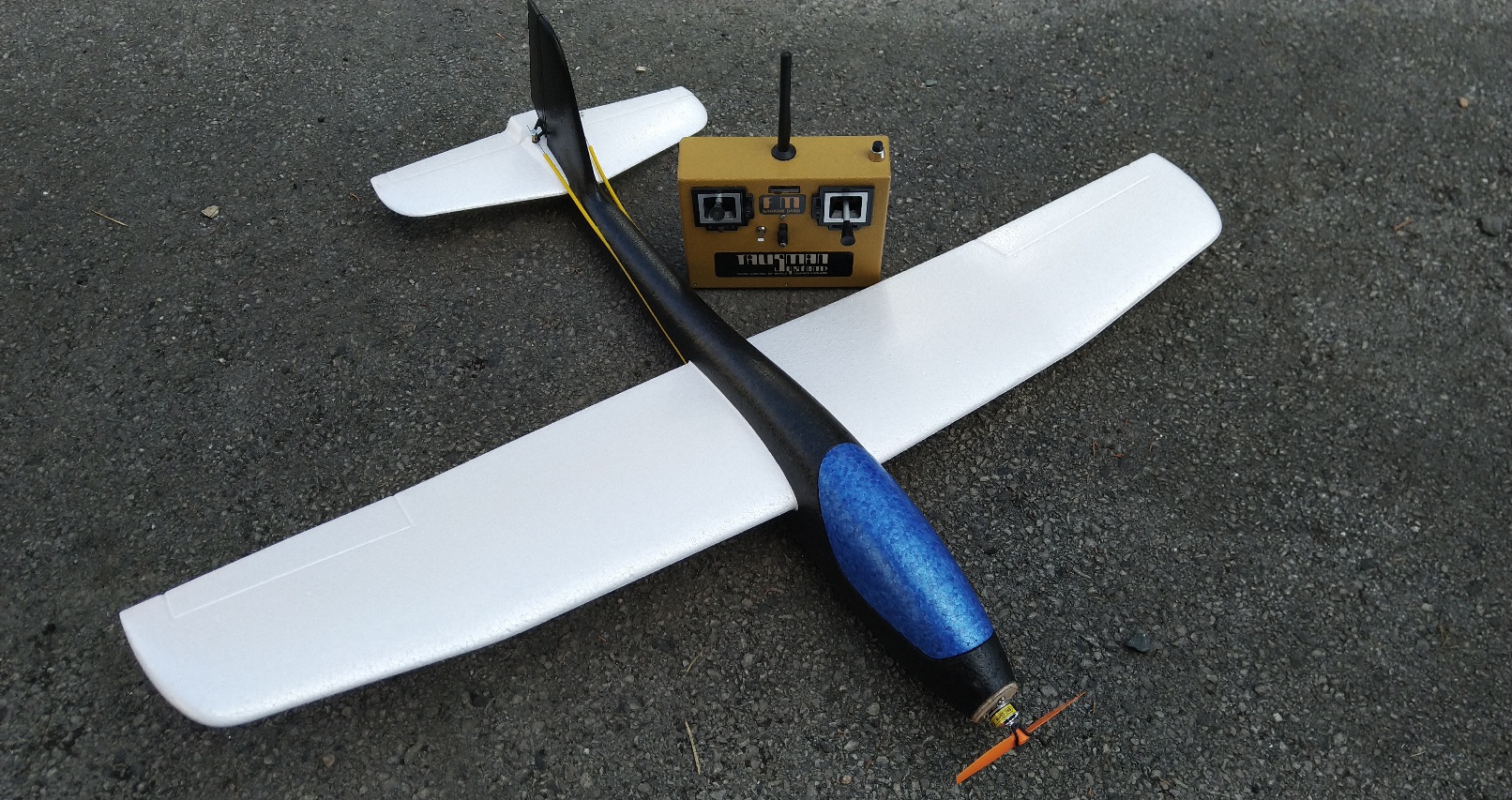

This is my latest "Fracter Bunt" In between 'serious' flying, we often put out a marker then have an informal spot landing (motor off) challenge with up to 8 assorted Lidls. It makes grown men giggle !

I have one of each variation and I agree with Martin, in light lift the R/E one out-soars the others easily.
The powered one pictured above is also R/E.
