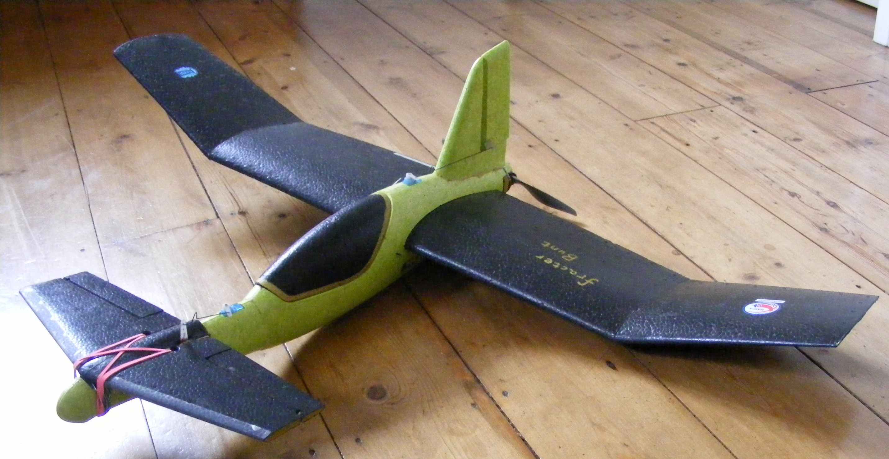

This is my latest "Fracter Bunt" In between 'serious' flying, we often put out a marker then have an informal spot landing (motor off) challenge with up to 8 assorted Lidls. It makes grown men giggle !

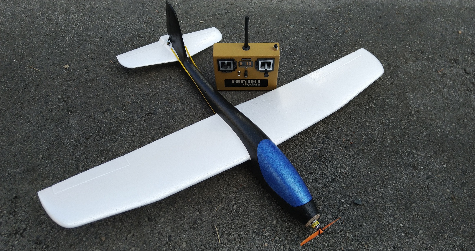

I have one of each variation and I agree with Martin, in light lift the R/E one out-soars the others easily.
The powered one pictured above is also R/E.

One assembly problem I found with this current version was the raised portion at wing centre was over-size and would not enter the fuselage without risk to both components. Resolved using a long sanding block faced with sharp new sandpaper to remove that bump to within about 0.5mm of the wing surface. It now goes together and seats nicely. I must now decide how I will modify it for RC.
btw, my canard is R/E only and now it is properly trimmed, flies quite happily on the button. 2S 900maH LiPo gives over 10 minutes powered flight. There is no brake on my ESC so when the motor is shut off the prop still windmills and it comes down like a brick dunny. Will install a folding prop when I get round to it.
