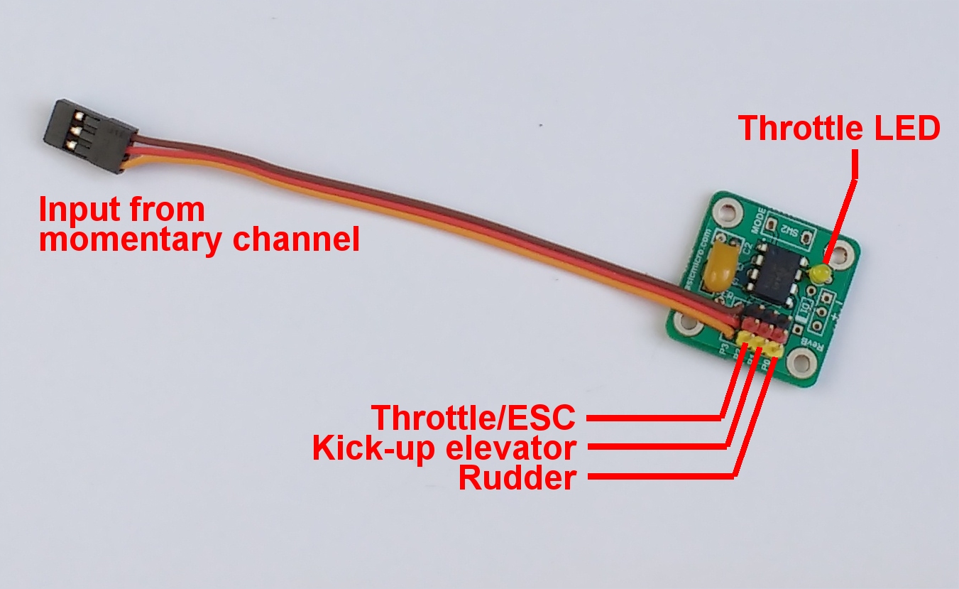

Phil_G wrote: 25 Apr 2018, 13:41 It is Larry, it has one plug into your receiver, and three headers for up to 3 servos.
For S/C with an IC engine you'd probably just use one servo, rudder-only.
If you decide to go that way, email me & we'll sort it out.
Meanwhile have a look at the document, its item P5 on the Archive page of www.singlechannel.co.uk
Email is philg@talk21.com

Re: Help Please.
Email me on philg@talk21.com with your postal details and I'll send you one FOC Larry.
Mike will have explained that you have one channel on your receiver (I dont know which,
probably channel 1) which simply follows the button on the transmitter.
Plug the escapement emulator into that channel, and your rudder servo into the emulator port 0.
If you want kick-up (I'd suggest not, keep it simple at first) the elevator servo goes in port 1.
If its in an electric model, the ESC goes into port 2 of the emulator and powers the receiver
down the single connection to channel 1 on the receiver.
Be aware its a bare uncased board, you mustnt allow any metal to short-circuit anything on the PCB.

Phil_G wrote: 26 Apr 2018, 12:34 Email me on philg@talk21.com with your postal details and I'll send you one FOC Larry.
Plug the escapement emulator into that channel, and your rudder servo into the emulator port 1.
If you want kick-up (I'd suggest not, keep it simple at first) the elevator servo goes in port 2.
If its in an electric model, the ESC goes into port 3 of the emulator and powers the receiver

Re: Help Please.
Posted a few minutes ago Larry. This arrangement will work fine, but long-term, if you find you enjoy flying S/C and intend to stick with it, I'd suggest replacing the simple on/off encoder with a proper S/C emulation encoder, that way you'd get rid of the on-board gubbins and you'd have a standard setup like most of us here. There are many options available - there's mine, Martins, and I understand from Mike (Ridley) that he also has a S/C encoder in the pipeline (but he's using Picaxe & programming in BASIC, and not surprisingly is having problems with timing) so talk to people on here & see which way you'd like to go.
At least for now with the escapement emulator, your setup will work fine, and will get you into reliable S/C flying. Let us know how you get on!
