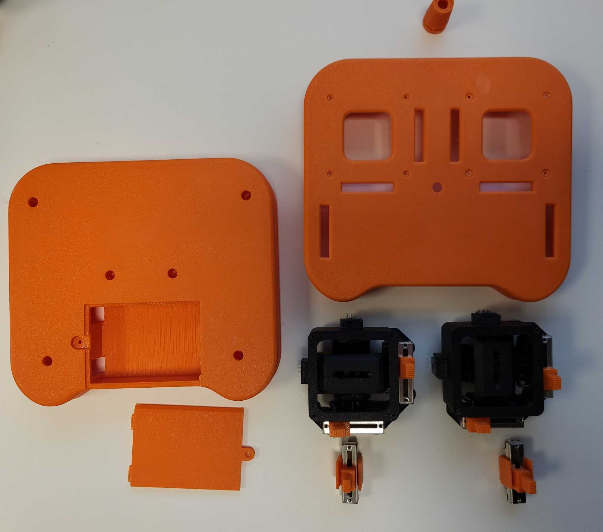

The printed parts for the case with the standard Mode_Zero stick
3D-printed in ABS but PLA will do, 0,4 mm nozzle,50 % infill with supports, my printer needed a total of 14 hrs between case and sticks.

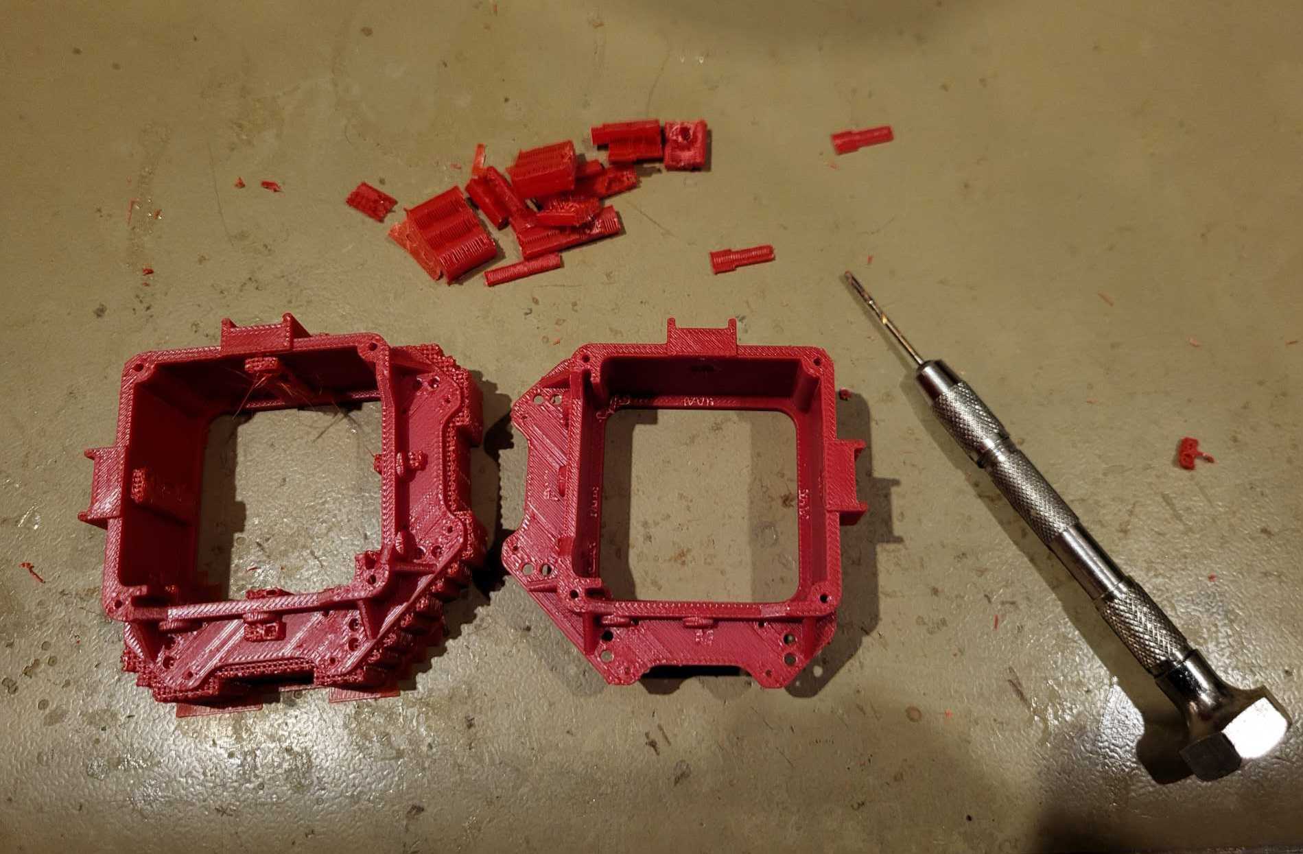

Cleaning up the printed part for the sticks

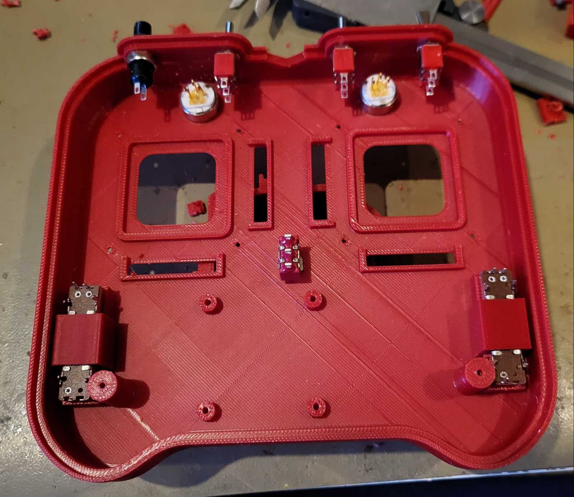

First position your switches and connect them, it's quite tight so you have to be carefull and thest with the sticks in position

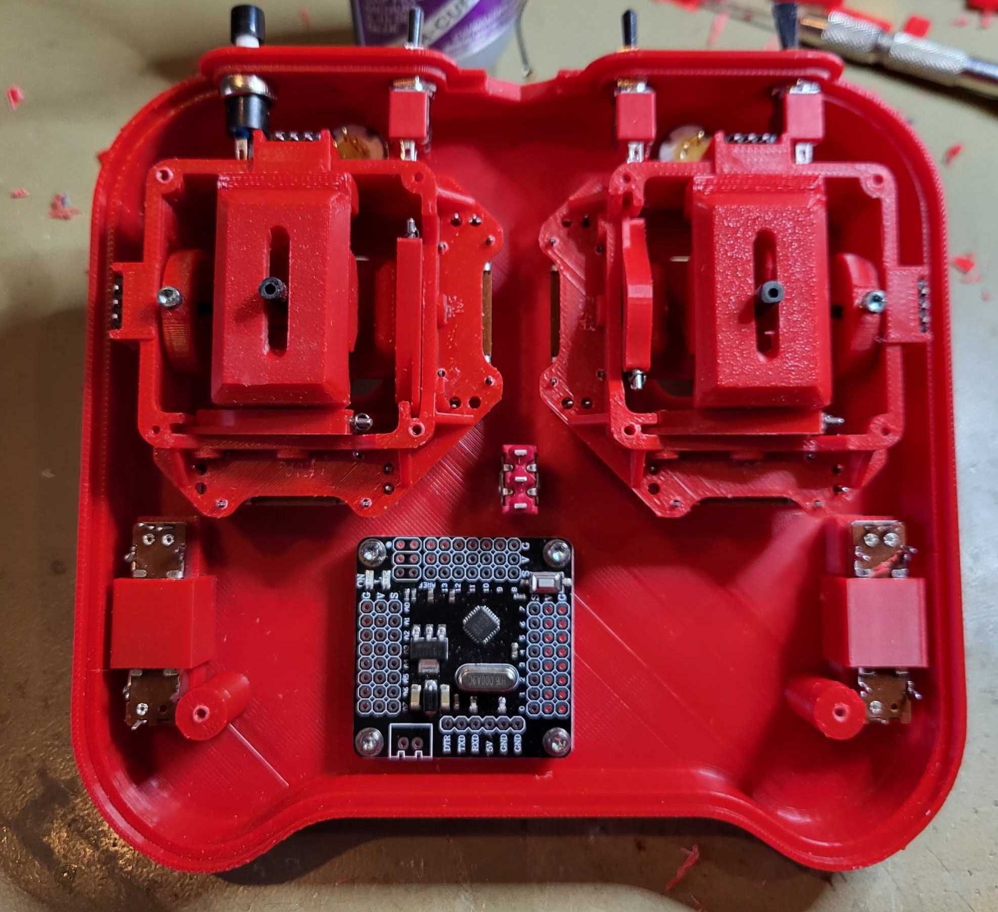

Showing here a "standard" DIY More board

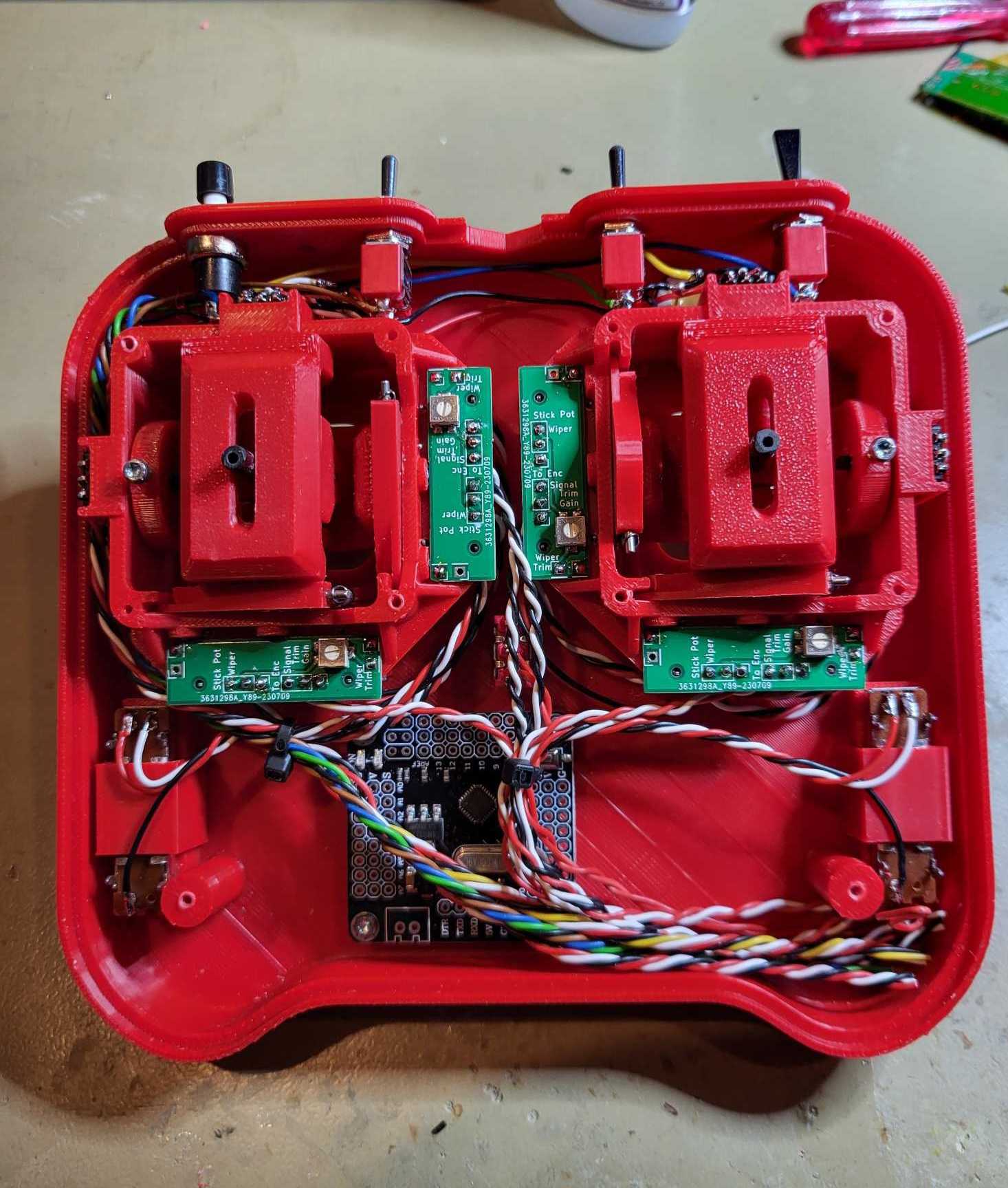

...not connected yet but the wires are there...have to decide for a version

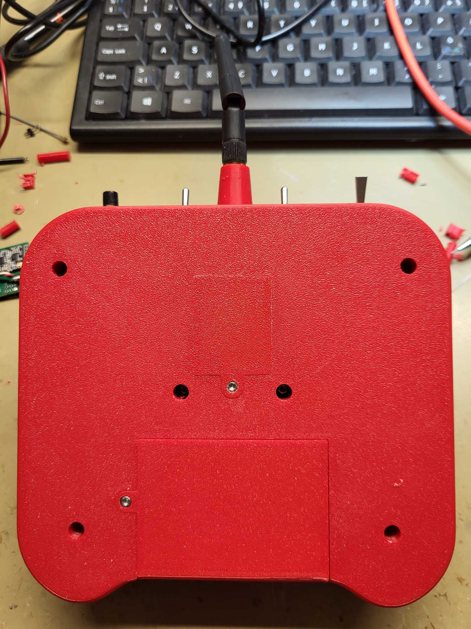

Back, notice ths 2 hatches

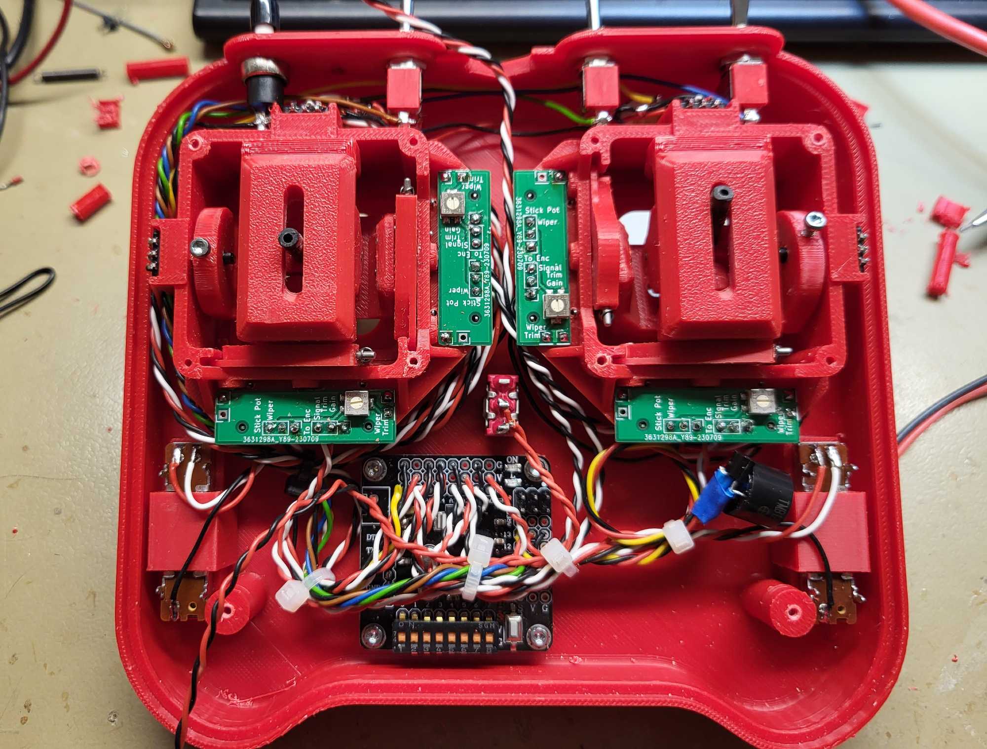

Top one could a Lemon RF-module but here I show my own nRF24 based one and the bottom one a 800 mAh 2s lipo and...
...access to the dip switches and the ICSP
...a Strong board wired up with Mike_K F3A sketch but could be reprogrammed easely w/o removing the back cover.

I noticed the boards that you installed on the back of the slider trim pots. I'm assuming these are for adjusting the amount of trim. Great idea. It looks like the pot is in series with the wiper on the slider pot. What value pot do you use on the boards? Thanks.
Posts: 714
Re: ...a case for the Mode Zero stick!
Hi Wayne, good to hear from you and would imagine that you are still in Florida.
From memory I would guess 20k and you would probably end having the trim pot set to 3/4, an easy way to set the gain for the trims instead to try and error loose resistors. The point is that in my stick I use the full movement of the trim pot.
