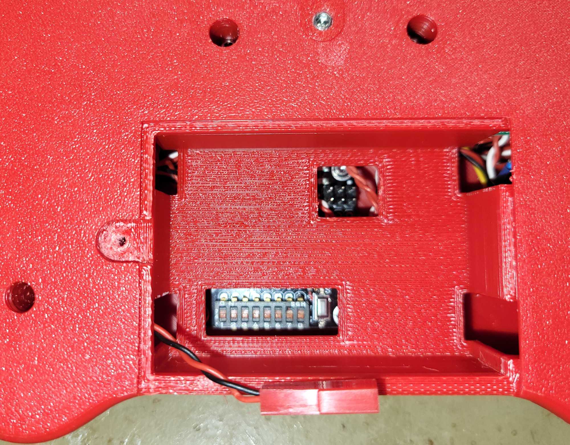

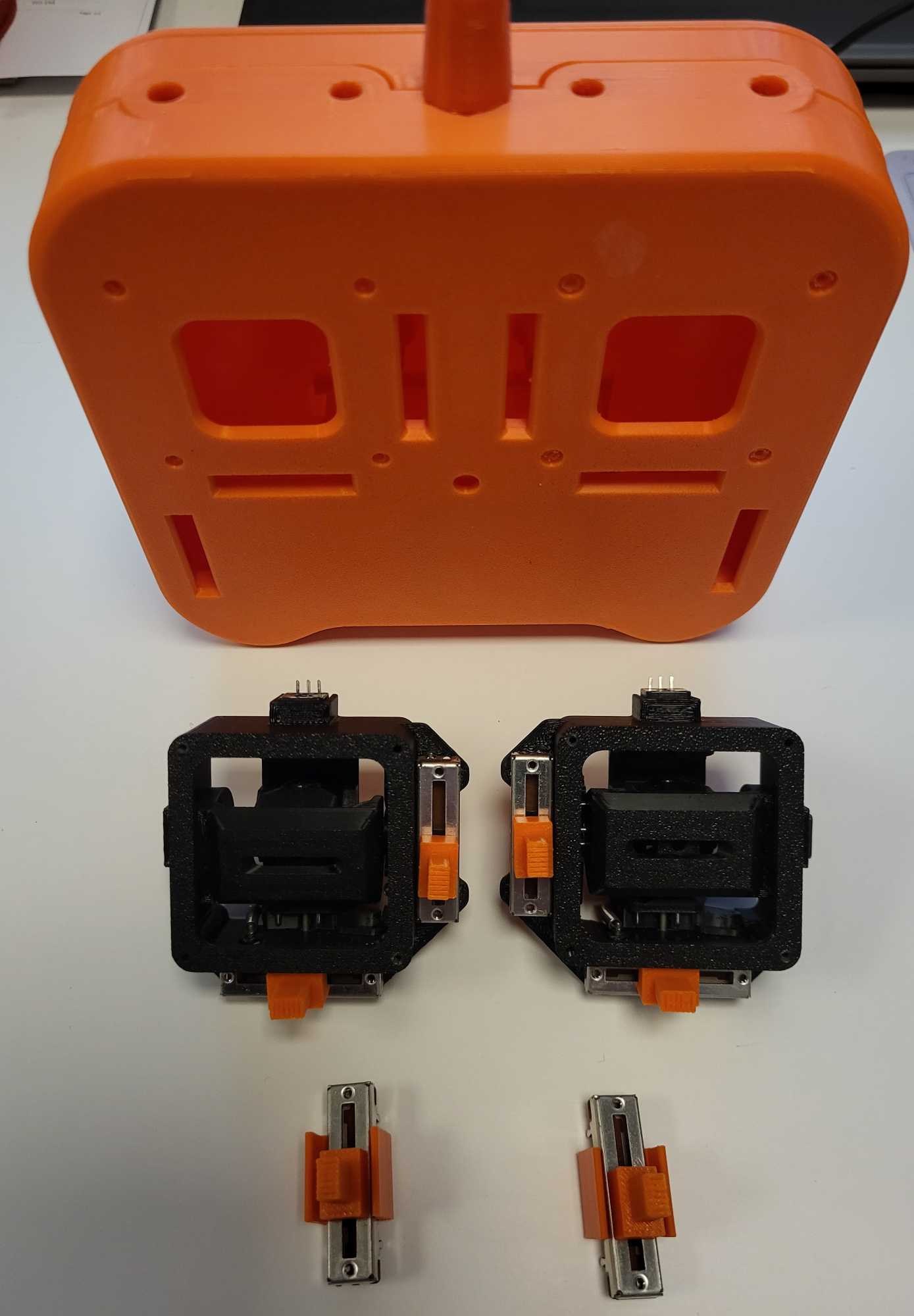

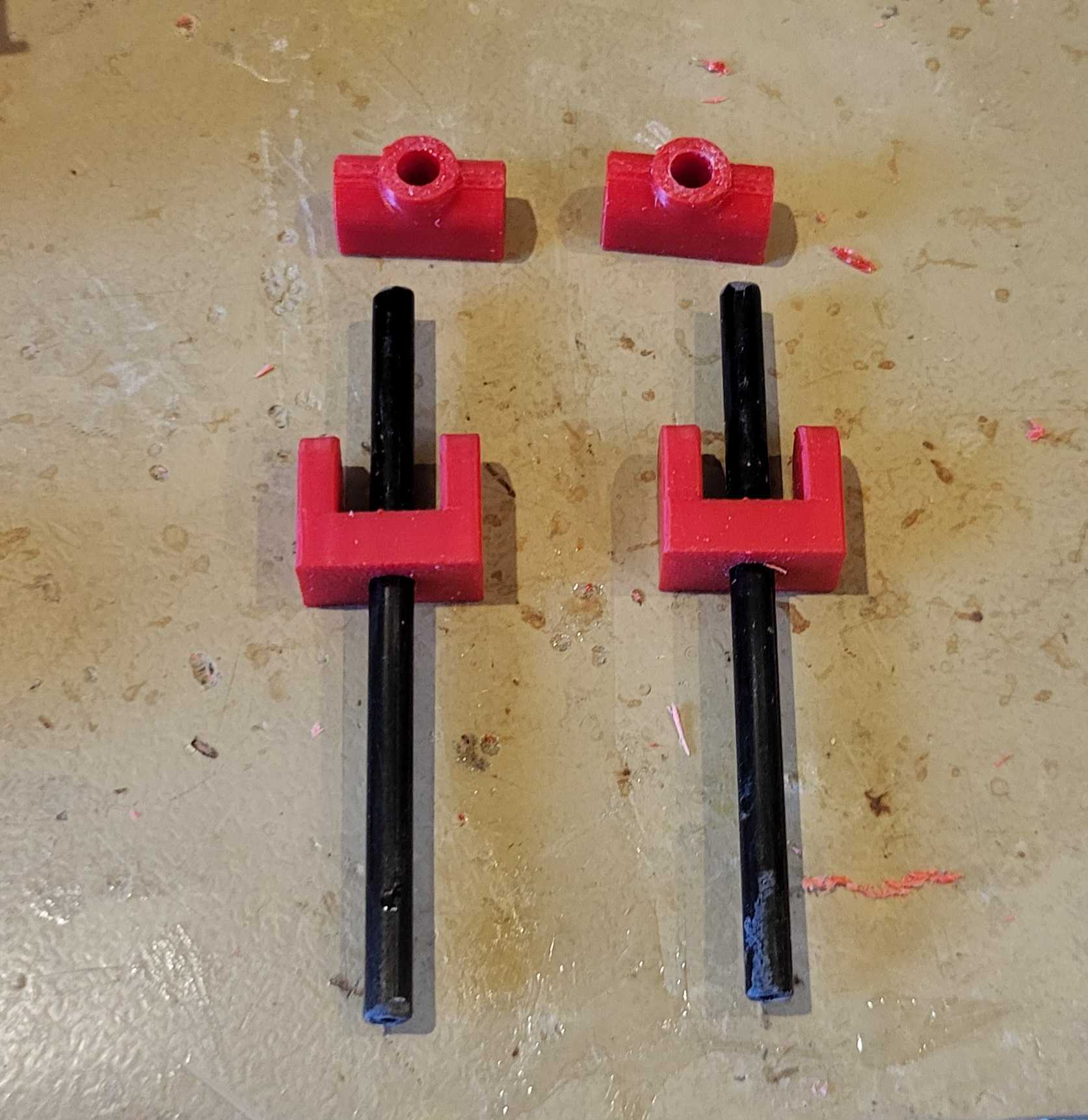

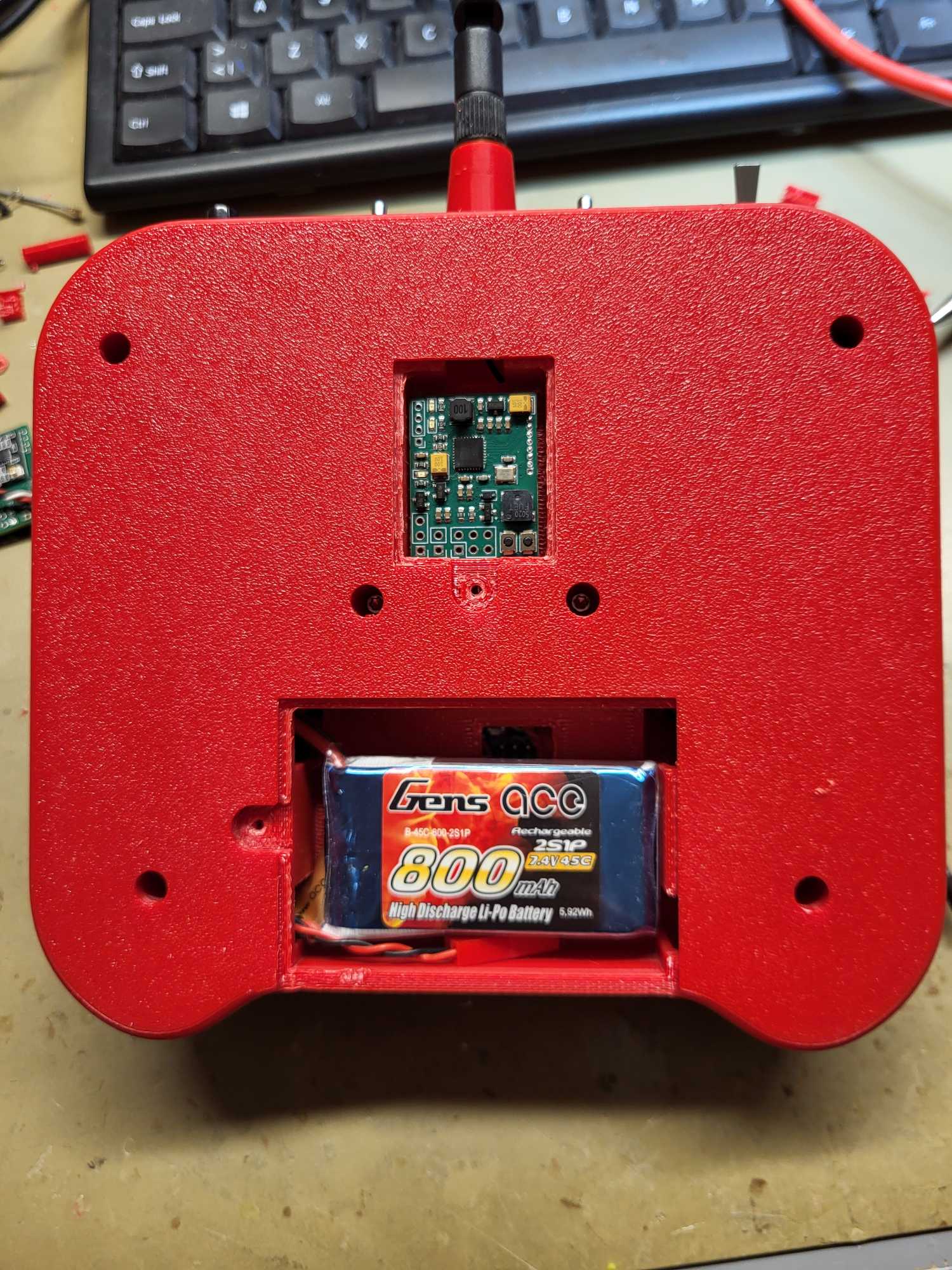

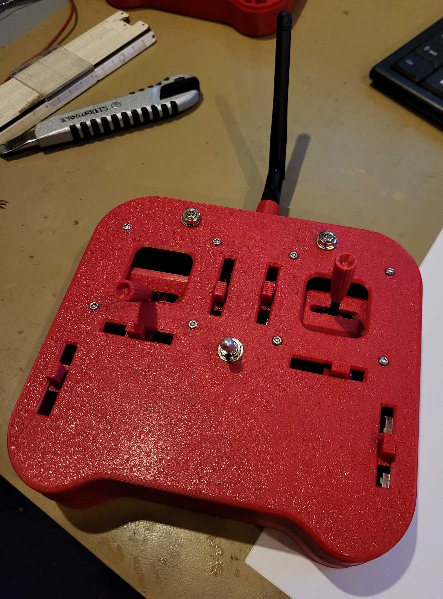

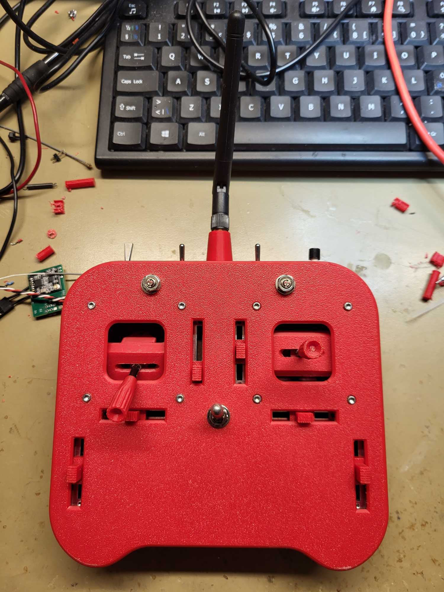

This is a project for those of you that once made the DIY stick 3D-printed that I presented a while ago.

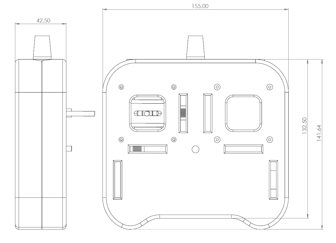

We are talking about a 3D printed Tx-case for 4+2 channels and a few toggle switches.
The size of the Tx is quite compact bur there shouldn't be any issues with space however you might have to opt for solder directly to the board your wires instead of using pin headers.
3D-printed in ABS but PLA will do, 0,4 mm nozzle,50 % infill with supports, my printer needed a total of 14 hrs between case and sticks.
Here are both the .stp-files as the .stl.
Unfortunately I don't have much spare time available for a full instruction but if you manage the DIY-sick this should not that difficult but if you are in doubt ask and I will do my best to assist you.
The .step file should allow you to make modifications like adding or removing features.
DIY-More Pro Mini size Encoders will fit nicely

I have updated with a new version, changes are the toggle switch holes which have been enlarged and some plastic has been added, nothing that affect the function but makes little more stronger.

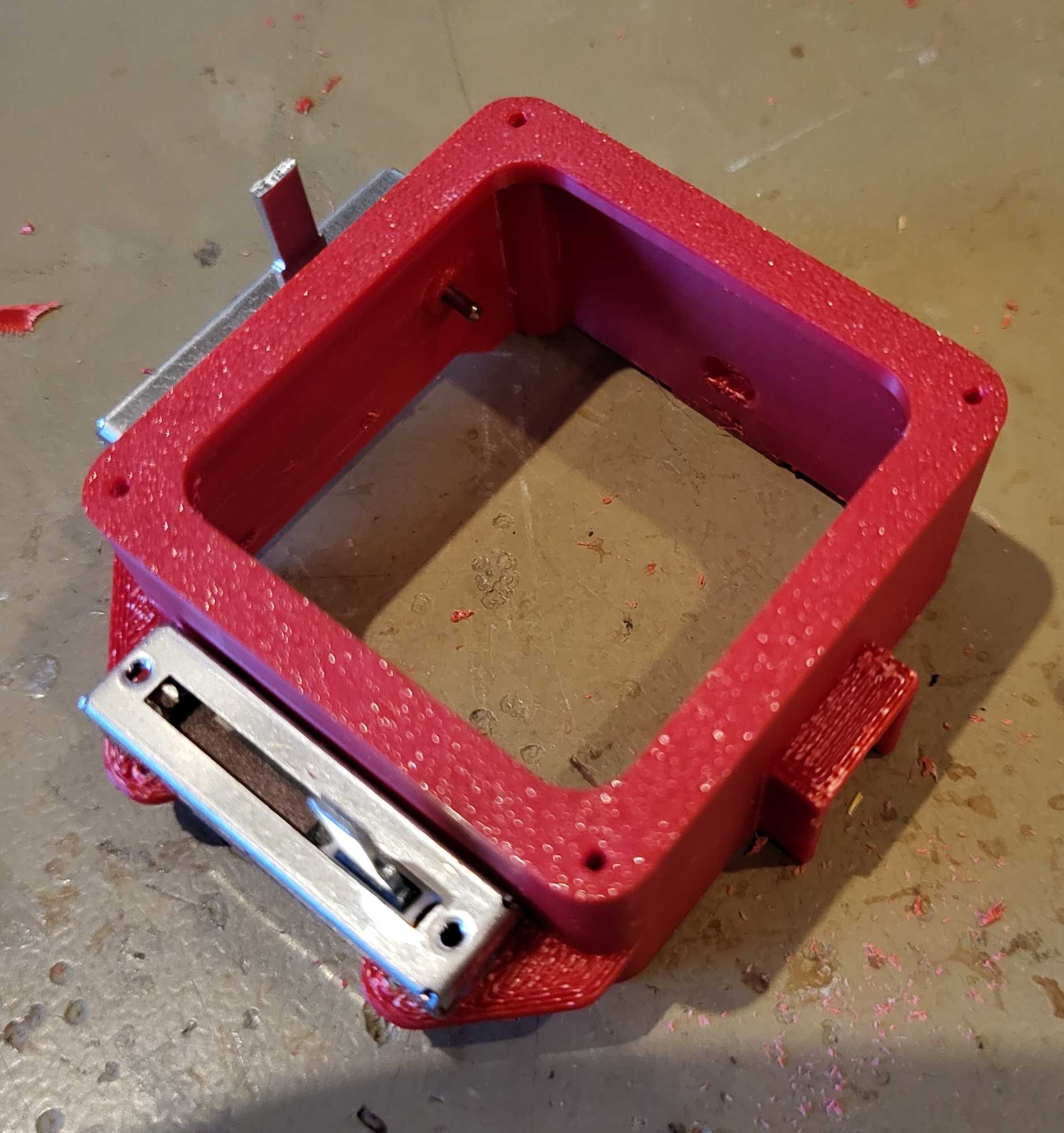

During the X-mas holiday and as my mane printer is free from making its bred and butter I will do this project step by step publishing relevant instructions and pictures as the building process goes along.
Please let me know if there any details that you might want to be added and/or removed and if reasonable I will try to offer the update file
2024-12-24
Have noticed an error in the file for the hatch so here is a revise file. I will start in a few days a building instructions as I build one from scratch in accordance with the files published here.

Very impressive case Tobe. Thanks for sharing the stl files. I will definitely print one when I get back home in the spring. I printed your joysticks last year. It was a fun project, and they have worked out great.
I noticed the boards that you installed on the back of the slider trim pots. I'm assuming these are for adjusting the amount of trim. Great idea. It looks like the pot is in series with the wiper on the slider pot. What value pot do you use on the boards? Thanks.

Hi Wayne, good to hear from you and would imagine that you are still in Florida.
From memory I would guess 20k and you would probably end having the trim pot set to 3/4, an easy way to set the gain for the trims instead to try and error loose resistors. The point is that in my stick I use the full movement of the trim pot.
