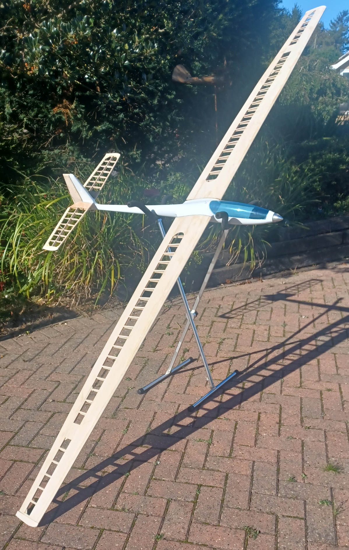

Thanks Spike with the closed loop suggestion, am still experimenting with the pushrod, but am getting some interaction between them despite tapering the rudder pushrod.

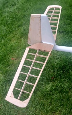

Anyway, busied myself with carefully (!!!) Bonding the elevator horn to its pivot rod and the incidence peg with thin cyano and lots of Vaseline where I didn't want glue to be, and......Phew it still moves freely!!
Made up a fin post laminated from balsa and spruce and dry fitted 3 pin hinges and a carbon rudder horn. Gave the elevator halves a bit of a sand too.
This is how the tail cone looks at teabreak today, starting to resemble Cirrus now.

Have managed to get the rudder operating now with the pushrod and got the 30 minute epoxy out and after smearing the moving parts with vaseline, the fin post is now bonded in place!

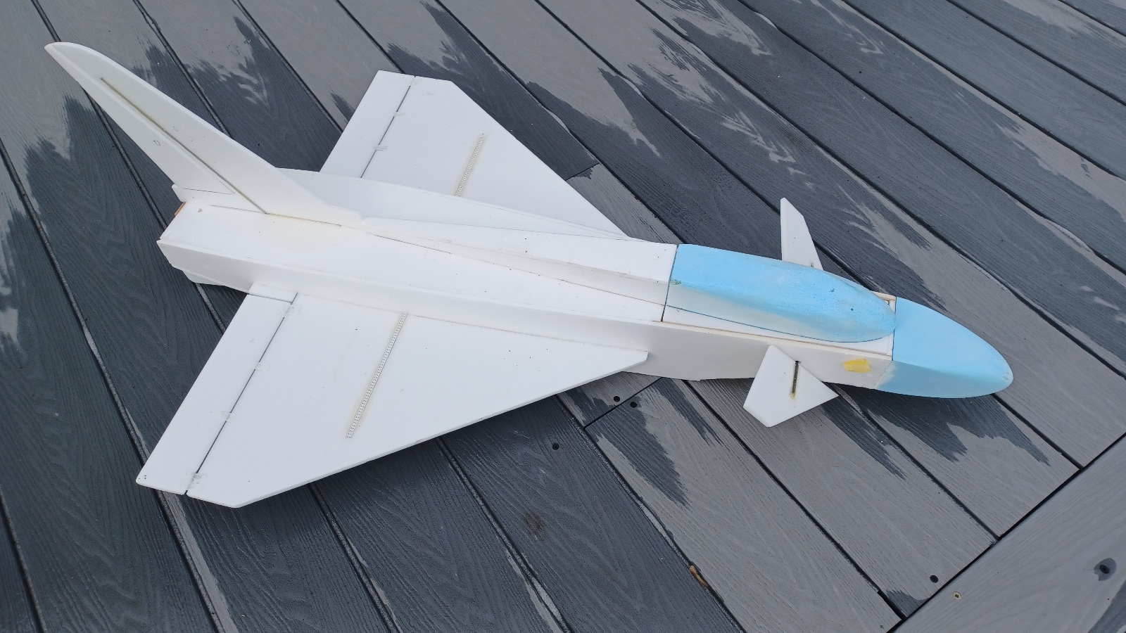

and whilst I has some epoxy leftover, I bonded the ply motor mount into one of Graham Gooch's amazing Depron Typhoons that has been in the workshop for too long and not requiring too many more coats of looking at! Two projects on the go at Swaffham Aircraft works now!

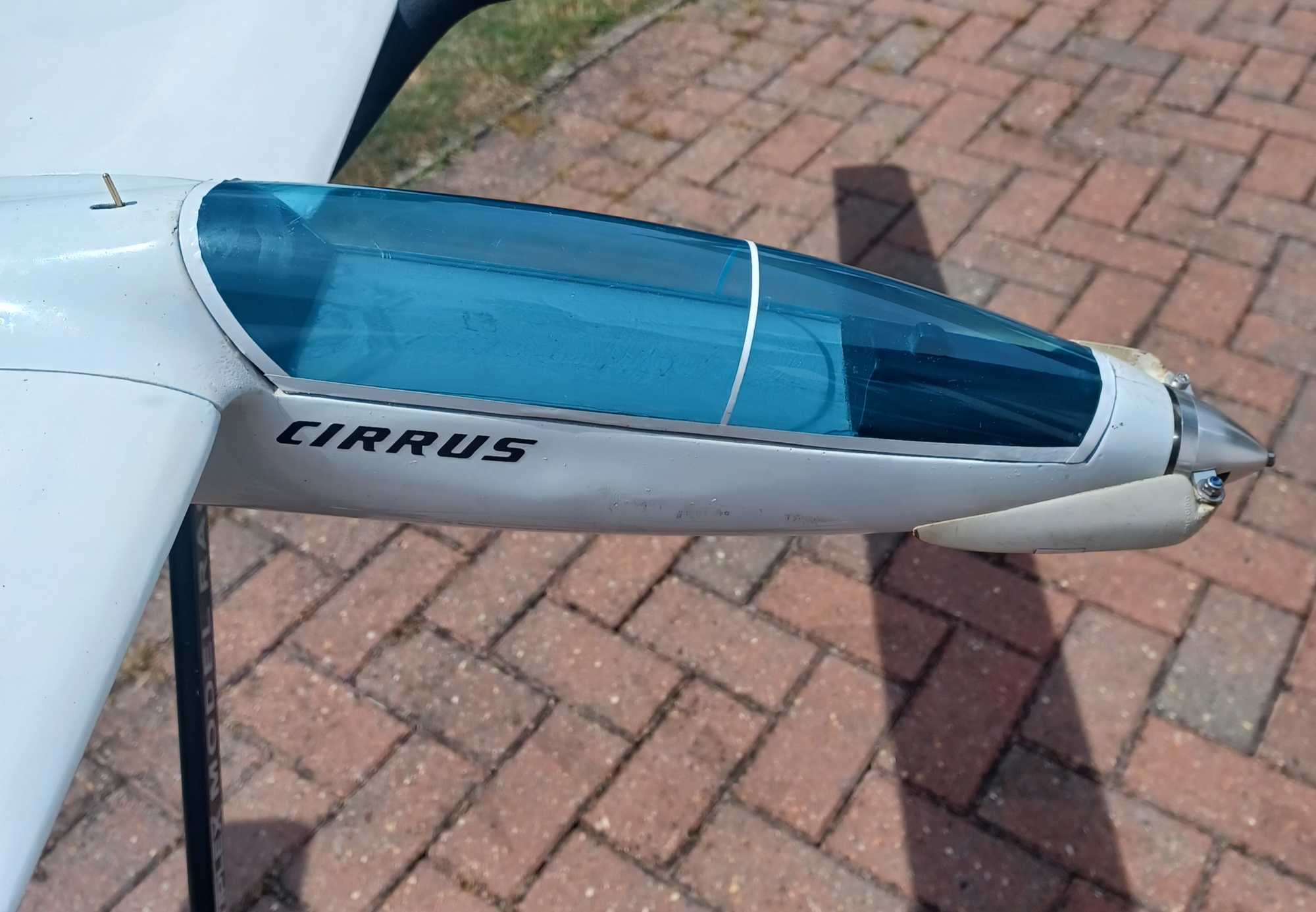

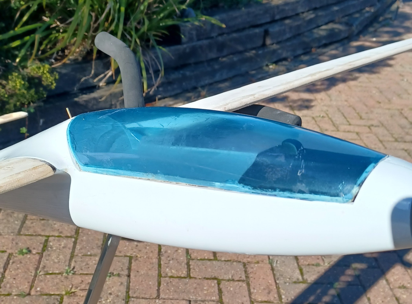

Canopy now bonded to its hatch and a final shot in the raw before a final sand and getting out the white Oracover.

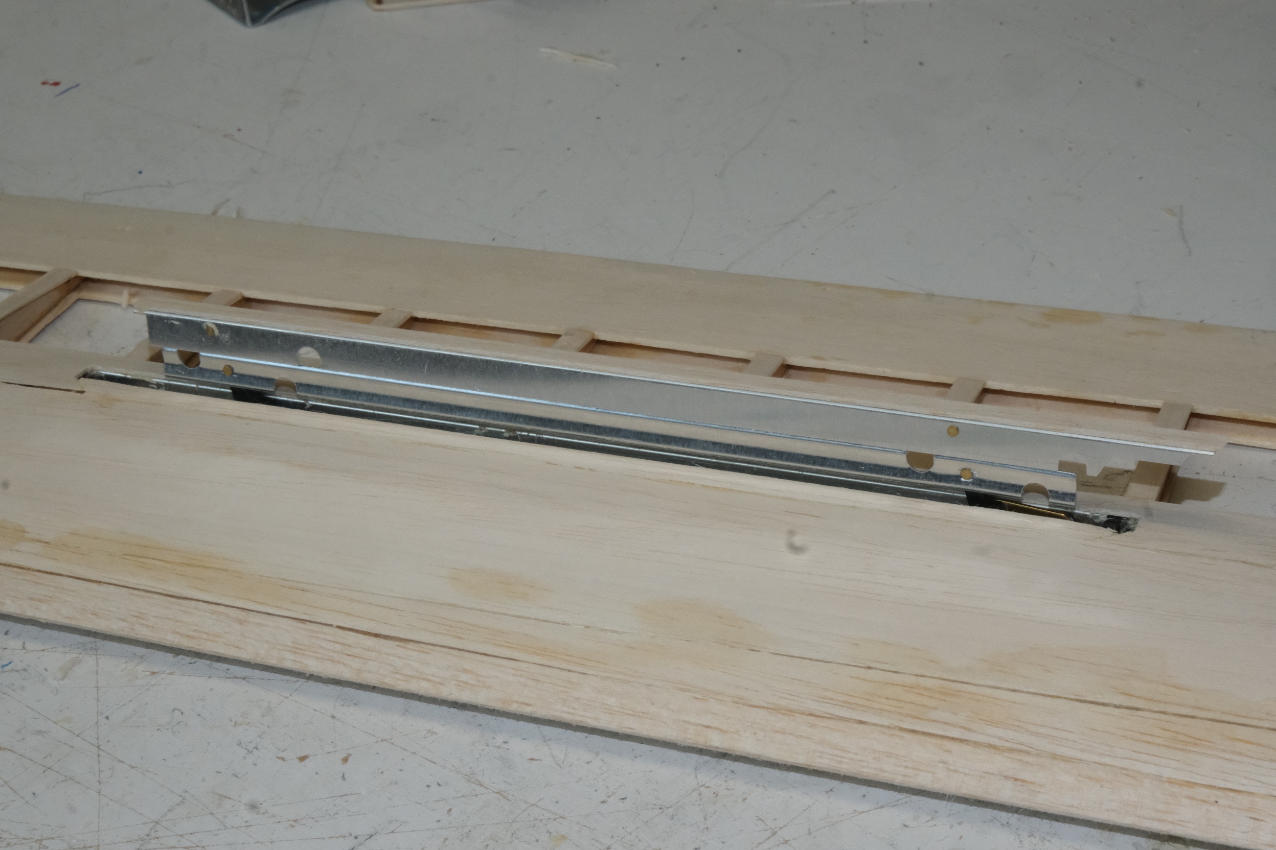

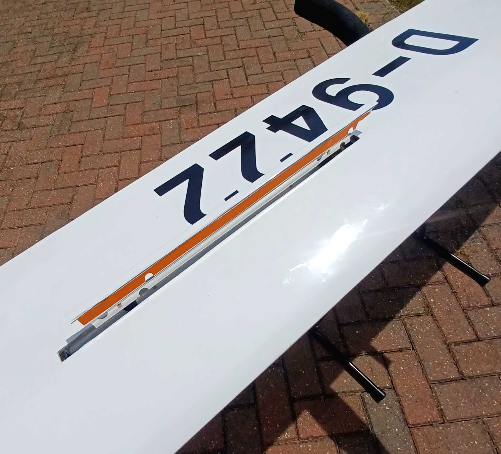

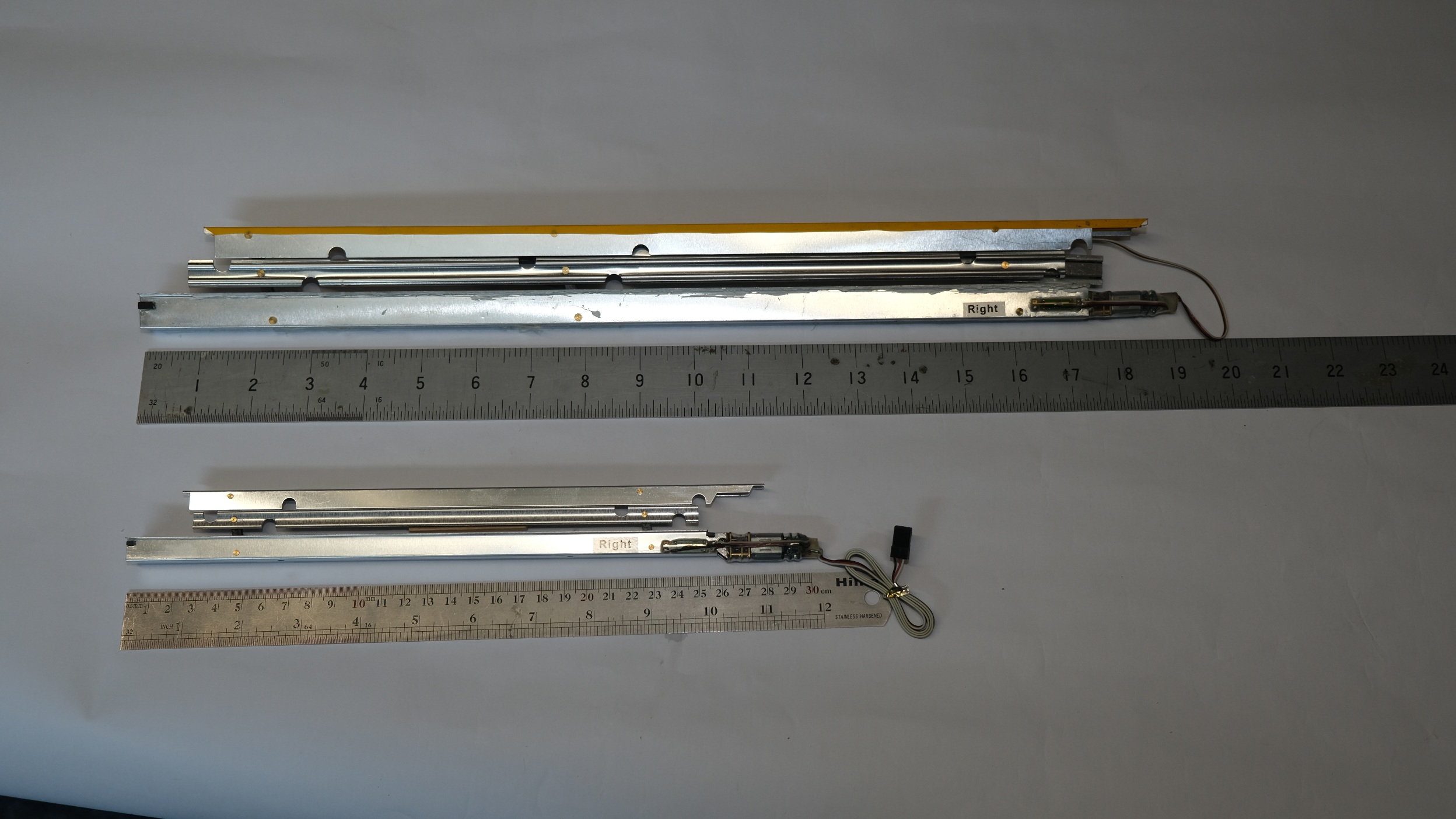

Just a quick update, I have decided to fit electric spoilers to each wing panel to try and make the landings a bit more controllable, so this has delayed progress on the covering and completion of the model and I will be back with more updates very soon!

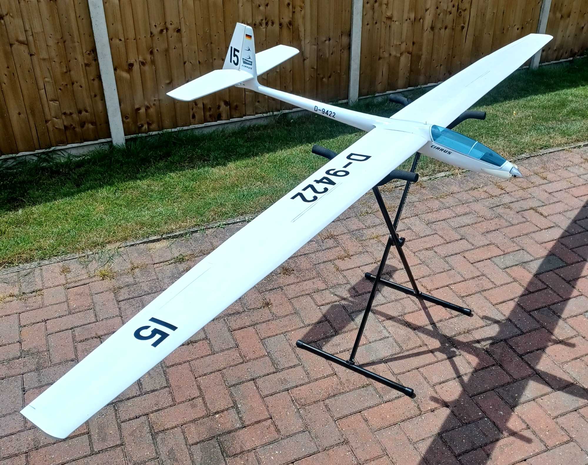

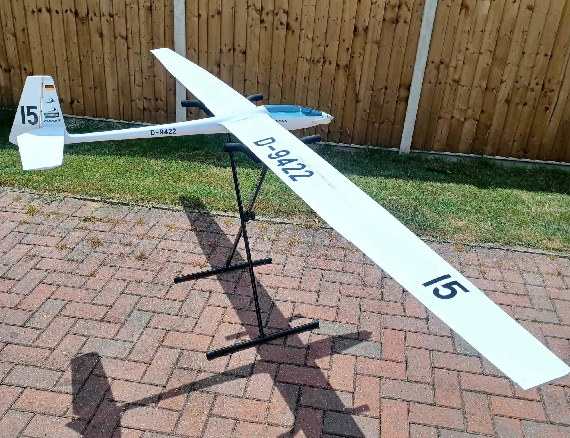

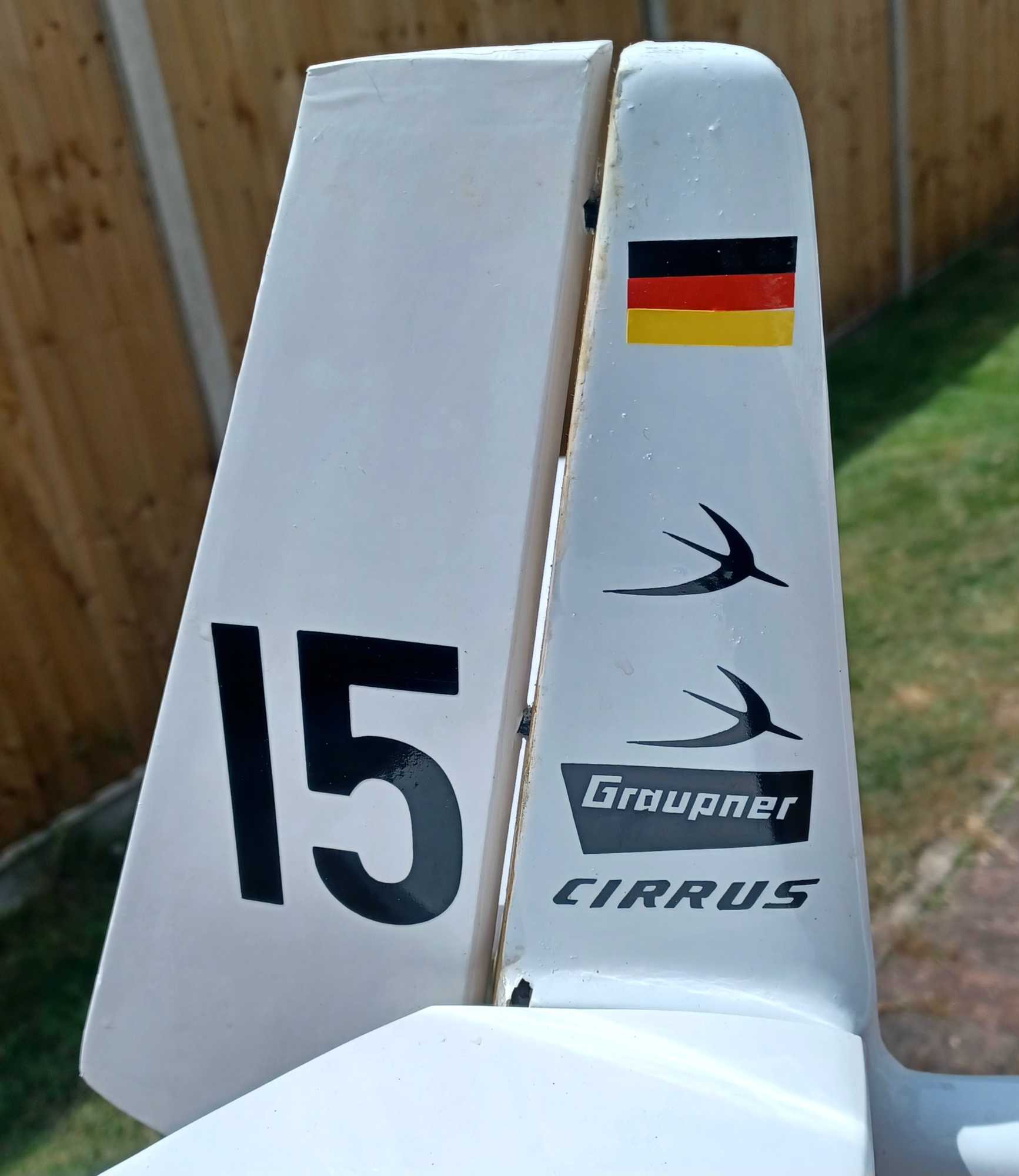

I have finally got the Cirrus finished, decals are on and Some lead added to achieve a safe(ish)CG!
Radio is Radiomaster TX16S, receiver Lemon Rx vario/gyro 7 channel, motor is a Kontronic geared fed by 3S 2200 Lipo through an Overlander 60A ESC, prop is a Aeronaut 9.5 x 5 folder which seems to give plenty of thrust!
Here are the obligatory pre flight photos!

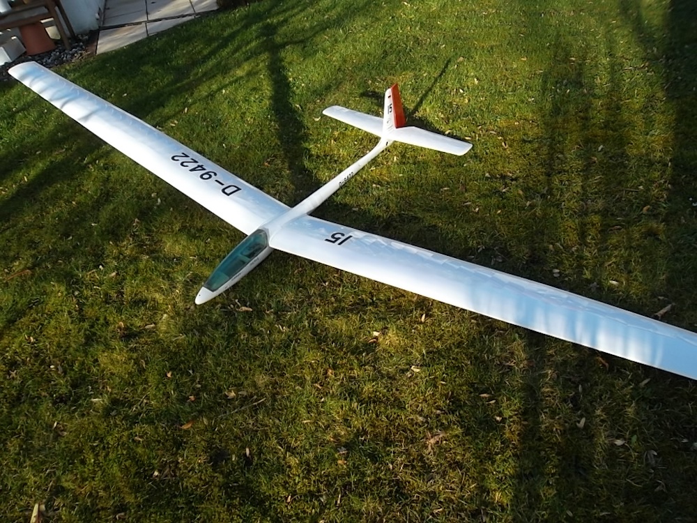

I'll be bringing the Cirrus to the Ponty Weekend, so come and say hi.... and for those who cant make it, here are a couple of in flight shots!
