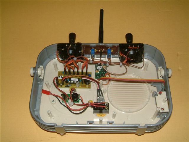

The transmitter is now complete and has been "smoke tested" successfully! I had to rethink my installation a bit, though:
Originally, I planned to put the encoder board in the empty right hand panel, mirroring the RF board, but it was just a fraction too wide! Instead, its gone under the aerial in the middle. This makes it more fiddly to plug and unplug things, but hopefully I won't need to do that often!
I've never handled a 10-channel Variophon before (mine is only 8), but there was a hole in the rear casing with a DIN plug behind it for charging. I don't know if this was standard, or whether it was done by a previous owner, but I had intended to put the "speed" pot behind it. Unfortunately, having to move the encoder has scuppered that idea, so I've put it in the battery compartment, as Frank suggested (more drilling seriously thick steel!).
At this point, I disconnected the RF board, and carries out a "smoke test" on the encoder, monitoring with a 'scope. Pulses appeared and appeared to move as expected, so next it was fire up the spectrum analyzer and check for RF output - YES! It was all there!

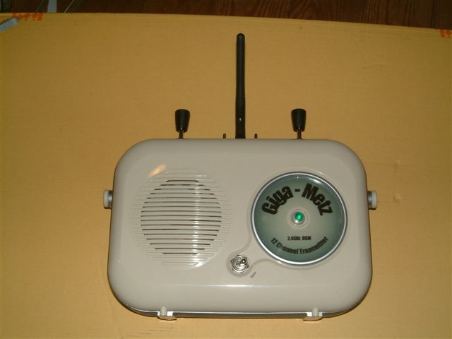

And here's the (almost) finished product:
I need to find a grommet to fill the charge socket hole in the back, and make a decal to cover the bind button and LED a bit better. Also the case hasn't gone back together quite as accurately as I would have liked - maybe theres a wire trapped somewhere, though I was pretty careful. Either way, I'd better open it up again and check, but that's a job for tomorrow!

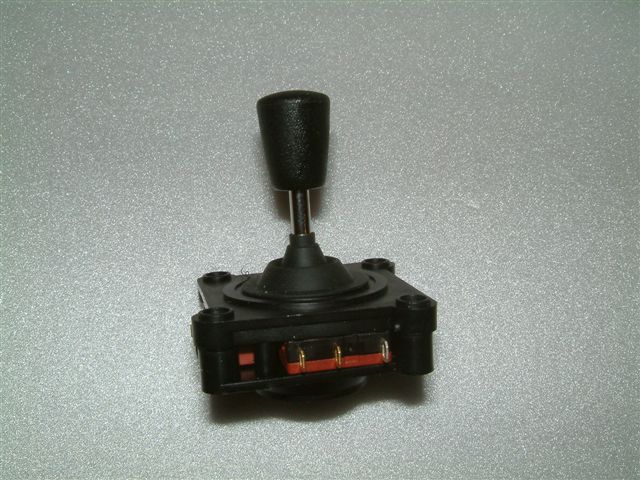

I do prefer the joystick type reed sets. As I couldn't find a suitable Tx to convert at the time( for sensible money) I used an FM retro radio Sainsburys had on offer for £15.00 and ripped out the guts. In fact it could qualify as a vintage set now as it used one of Phils early hand etched PCB's for the 10 channel reed encoder. :lol:
The micro switch stick units are superb and very well engineered, from memory only about £12.00 each.

Shaun: Yes, I remember your faux Metz! Where did you get those switches from? I ought to get a set to play with.... :)

I seem to remember getting the switch units from Farnell. They are excellent quality and have a great feel, just enough resistance but not like car window switches .
