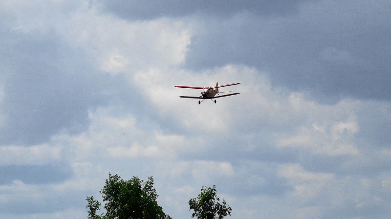

Mr. Kraft cranking in the turns

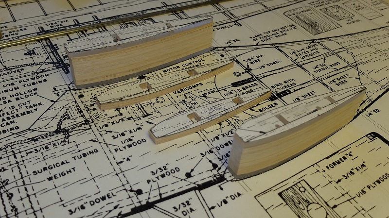

I made a set of ribs first

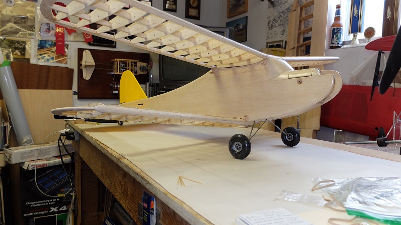

Rigging up the dihedral with the symmetrical airfoil and keeping it straight required some imagineering

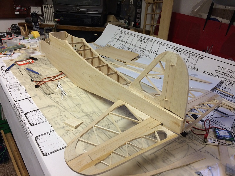

The fuselage taking shape & tail feathers completed

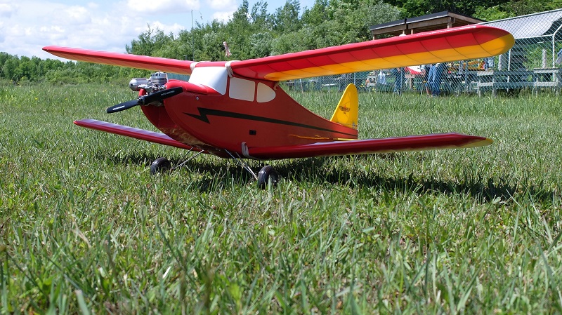

A "before shot" ready for test flights.
The ground roll was all over the place like a dog sniffing for somewhere to.... Once off it flew quite well. Rock steady on the glide in.

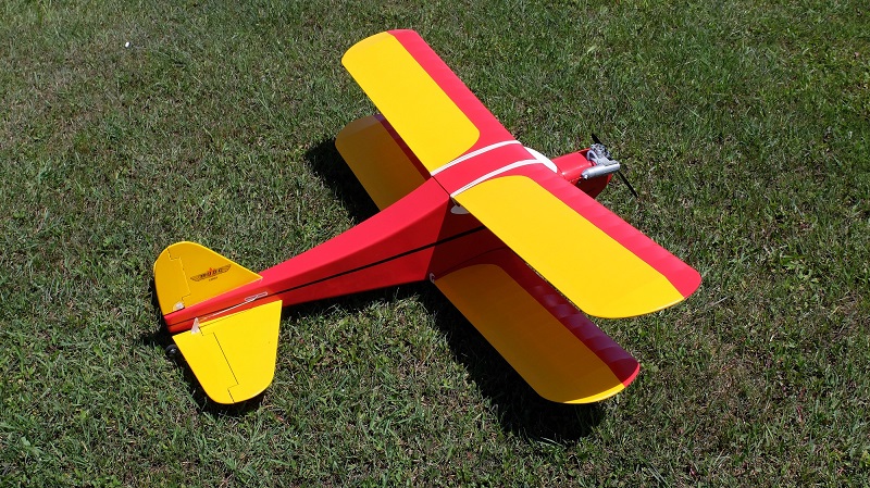

Here is an "After Shot" back on terra firma in one piece
