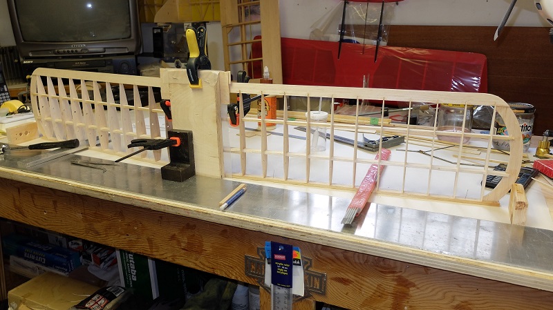

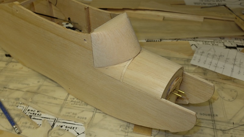

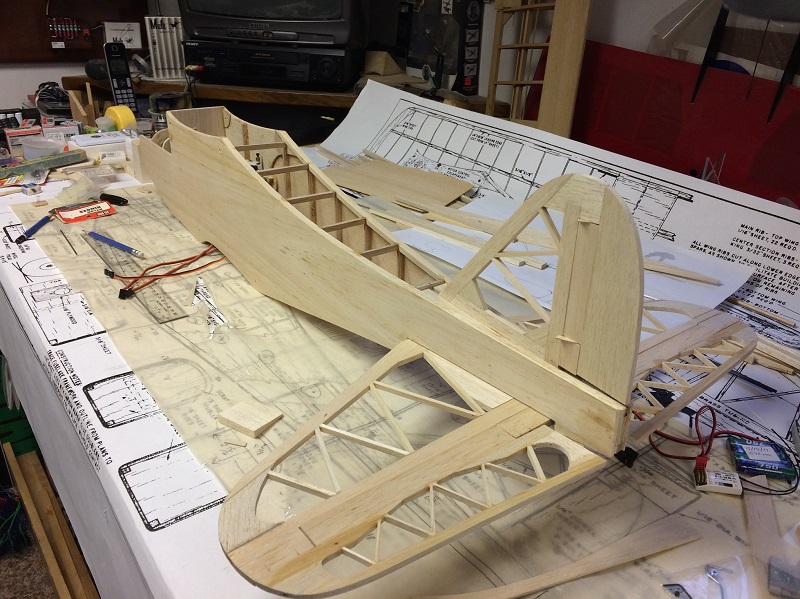

One day while perusing Outerzone I found the listing for the Bi-Fli plan, promptly downloaded and had them printed off. Construction started immediately .. well in a day or so. I thought this would be a great model for my then recently converted single channel Ace Commander transmitter.
My workbench real estate is getting cluttered!

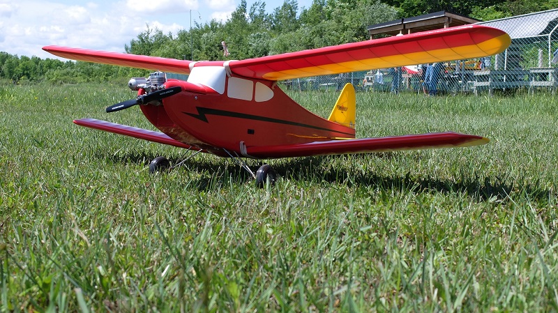

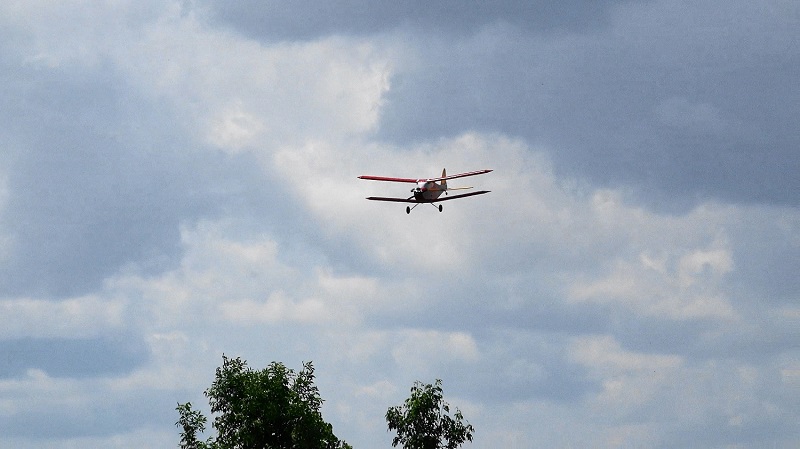

I have to admit I cheated a little bit (a lot actually!!) by installing proportional gear for the several test flights. Good thing I did or the "after Shot" might have had more pieces. I had to wonder how did they ever manage using only single channel to (a) keep up elevator to stop nosing over while simultaneously steering with rudder and also trying to Morse code throttle settings?
Some time later I found some you tube video of Mr. Kraft flying the Bi-Fli off a hard surface. All (!) he had to do was WOT and steer! Our runway is grass. I also found a later video of the MkII version with a much taller fin & rudder similar in shape to that on a Stinson 108-3. This version utilized 6 channel reeds.

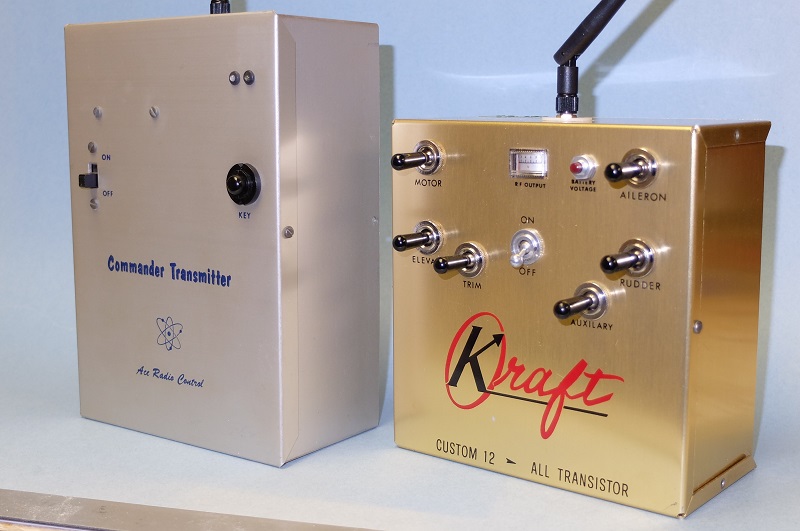

I now have it ready & waiting for more for test flying using my converted Kraft reeds transmitter just in time for our annual 6 month ice age to set in.
I think I will find another project for multifunction single channel.

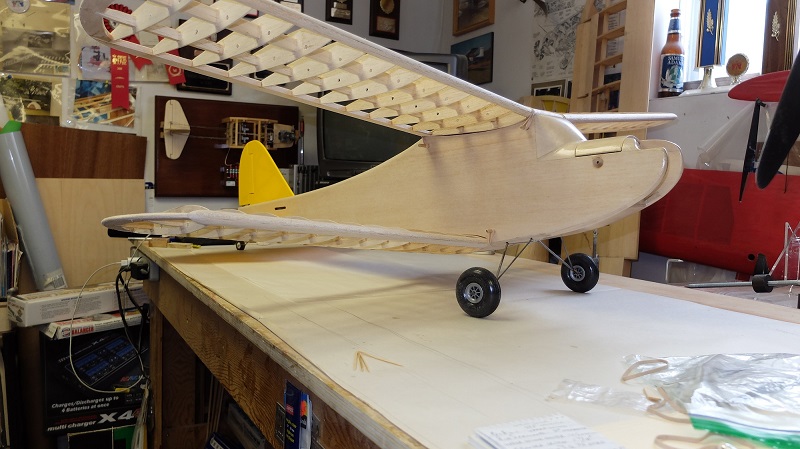

To improve ground handling try some 'toe in' on the main wheels.

A good suggestion jackdaw. I will bend some toe in prior to the next flying session and see how that works.
Right now the wheels are aligned straight ahead, they probably toe out during the take off roll due to flex in the LG wire.

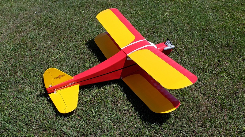

I used an OS 15 FP with an APC 8 X 5 prop. Seems to be plenty of power. In fact I throttle down to 3/4 or so for normal flying. The glide with that symmetrical airfoil is surprisingly good and very stable.
Not sure what it weighs. The flight pack consist of 3 standard size JR NES 505 servos because that's what I had and they were new old stock, 600ma 4 cell AA NiCad battery, JR switch, FrSky V8R7-II Rx. Covered the wings and tail with Solartex, fuselage with silk span & clear dope, sprayed on a white dope base layer and masked out the windows and spayed on the red dope, then sprayed automotive clear over everything to insure fuel proofing. So you can see other than some pretty nice wood that I had on hand I did not make any extra effort to keep it light. Although our grass field is well maintained I wanted to make sure the plane would be rugged enough to last!
