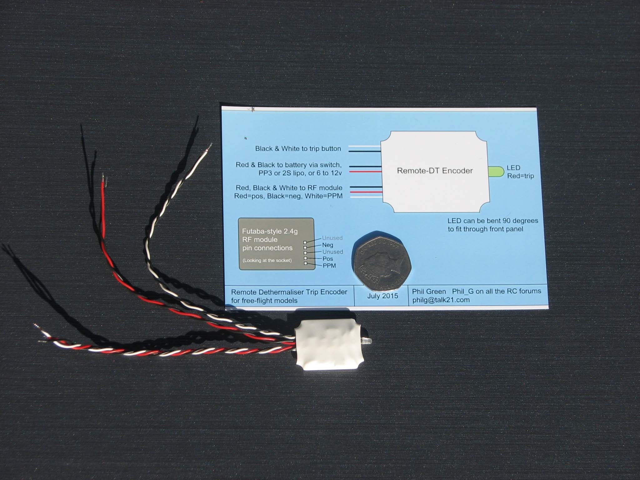

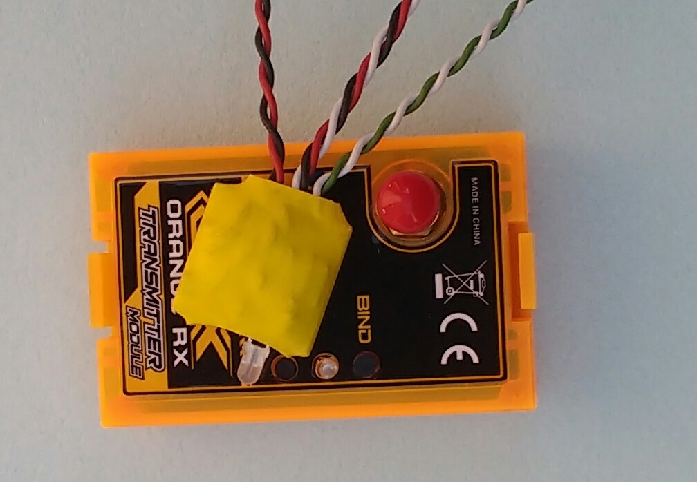

I'll vouch for the efficacy of Phil's RDT trip. Simple, small, and easy. Works beautifully, and avoids any rubber band burning.
Re: RDT QUESTION

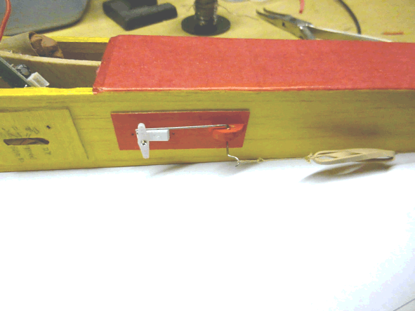

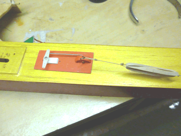

The RDT's I've been doing for a while now use a conventional servo Gary, small as poss, say 1.5gm
Lemon receivers seem most popular and a small single lipo cell.
The device itself is embarrassingly simple but thats what FF'ers wanted, I offered timers and stuff but they particularly wanted the simplest most basic trigger mech so it could be ratified as acceptable in competition. The FAI rules I believe permit only a 'single, one-shot transmission to irreversibly trigger a dethermaliser' which is exactly what it does and no more
- Attachments
- Remote Dethermaliser3.pdf
- (164.96 KiB) Downloaded 227 times

I'm aware of the RDT gadget you make Phil, in fact you generously gave me one of them when I was last in the U.K. What I was thinking though, was something like shorting out a servo plug with a short length of nichrome wire to burn through a dental band. Reason being, no tiny servo to overload and no mousetrap to release the dt line and if they don't exist they can't weigh anything. I was mainly wondering if a receiver can do something like that without bursting into flames and the signal would have to be momentary and one shot for the very rasons you mention.
Gary

Thanks Phil,
This is what got me thinking....albeit his timer is set with little switches whereas I was asking if it could be activated by a radio signal. I hope it makes sense...
Gary
