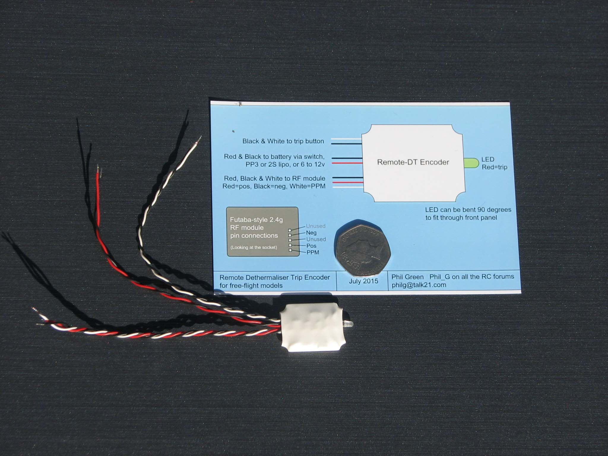

I believe PhilG has a system that he could advise you on. He'll no doubt see this post and give details.

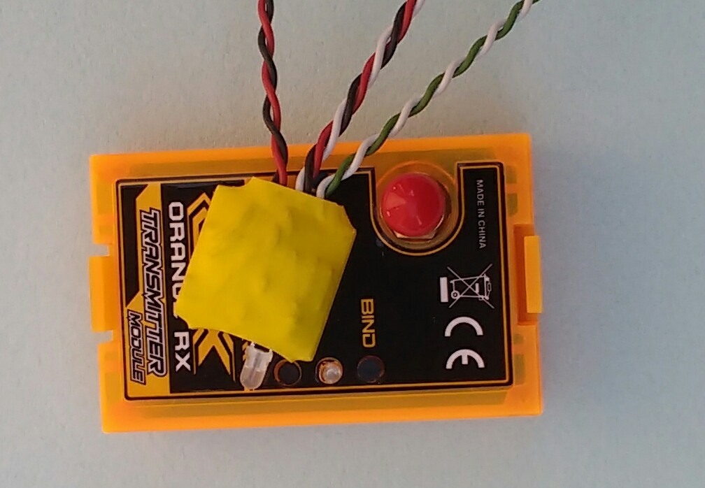

I'll vouch for the efficacy of Phil's RDT trip. Simple, small, and easy. Works beautifully, and avoids any rubber band burning.

The RDT's I've been doing for a while now use a conventional servo Gary, small as poss, say 1.5gm
Lemon receivers seem most popular and a small single lipo cell.
The device itself is embarrassingly simple but thats what FF'ers wanted, I offered timers and stuff but they particularly wanted the simplest most basic trigger mech so it could be ratified as acceptable in competition. The FAI rules I believe permit only a 'single, one-shot transmission to irreversibly trigger a dethermaliser' which is exactly what it does and no more

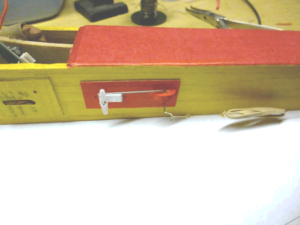

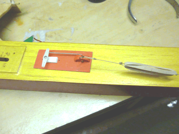

Just thought I'd mention that the DT method I use is extremely simple and although it's in a freeflight model and actuated by an electronic timer, it could just as easily be driven by a lightweight receiver.
There are lots of electronic timers available for freeflight, and many (all?) of them have at least dual outputs to allow control of a) an electric flight motor and b) a DT function, driving a tiny servo. The motor control allows pre-set speed and run duration to be controlled, whilst the DT servo is triggered after a suitable delay. I use a simple, very light, carbon pushrod 'twixt servo arm and the pop-up tailplane. It terminates in a short length of piano wire that at the tail end, holds down a small piano wire hoop glued into the tailplane trailing edge. When the DT servo is actuated, it drives to one extreme position, withdrawing the wire from the hoop and releasing the tailplane to its DT position. The tail tip-up is powered by elastic bands in the usual way.
Note that the pushrod is only ever under tension, so rigidity isn't required and it can therefore be very light. At the tail end of the fus, the piano wire runs in a bearing comprised of a short length of brass tube.
There are no sacrificial elastic bands to worry about. Re-setting is a simple matter of pulling the t/p back down to its flight position and re-setting the timer so that the servo returns to its "hold" position. That drives the pushrod back through the hold-down loop, and off you go again. I'd suggest using a 3-gram servo: you just need enough movement on the servo arm to ensure positive hold-down.
That's made it sound more complicated than really is, but I can post/send photos if necessary. The point is that the servo is only responding to a signal from the timer, and that signal could just as easily be generated by an r/c receiver.
Hope that helps.
