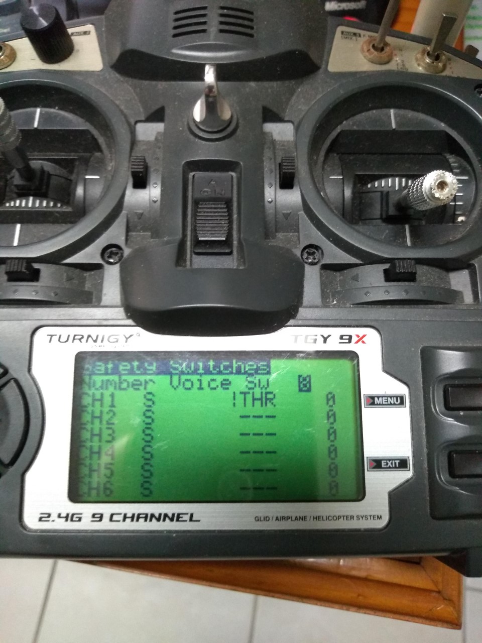

Have a Turnigy 9X radio with ER9X software installed and have been playing with the settings all day to get it how I want it.
Thought it might be useful to others in here at some time.
Rather than have a centre stick position as "OFF", my idea was have the throttle stick go from zero to maximum on both forward and reverse and this forward /reverse selected via the rudder switch. Not a new idea overall but setting it up apparently is.
With the throttle cut switch set as a safety switch, nothing happens. (default turn on...all switches set backward)
First I set 2 curves to take care of the stick movement for forward and reverse.
Then I set the safety switch on the throttle so no motor run could occur at startup.
So, turn on, set safety switch forward position and with the rudder switch, select either forward or reverse motor run.
Throttle goes from zero speed to maximum in the selected direction.
9x radio boat throttle

Also just found safety switch menu and set one up as throttle cut on radio turn on.
