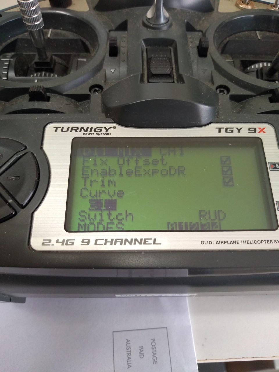

Have a Turnigy 9X radio with ER9X software installed and have been playing with the settings all day to get it how I want it.
Thought it might be useful to others in here at some time.

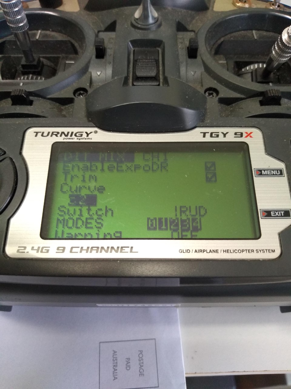

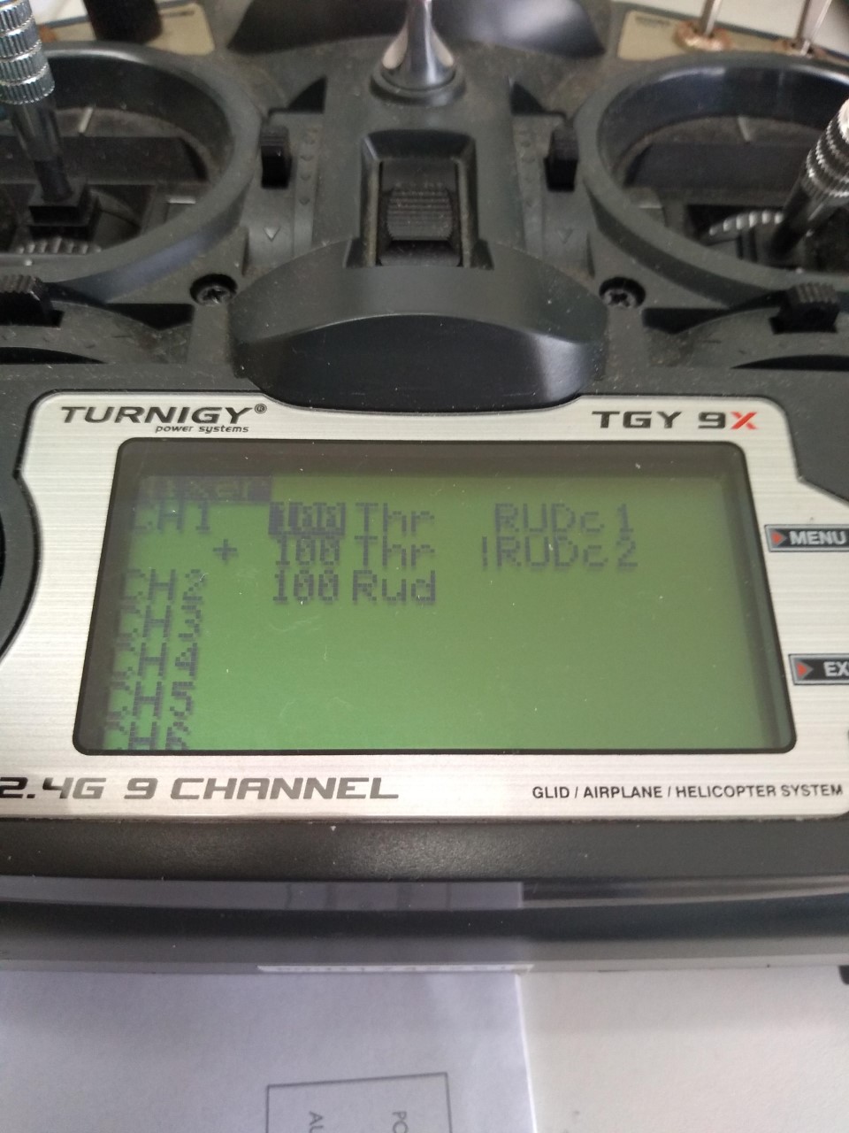

Rather than have a centre stick position as "OFF", my idea was have the throttle stick go from zero to maximum on both forward and reverse and this forward /reverse selected via the rudder switch. Not a new idea overall but setting it up apparently is.
With the throttle cut switch set as a safety switch, nothing happens. (default turn on...all switches set backward)

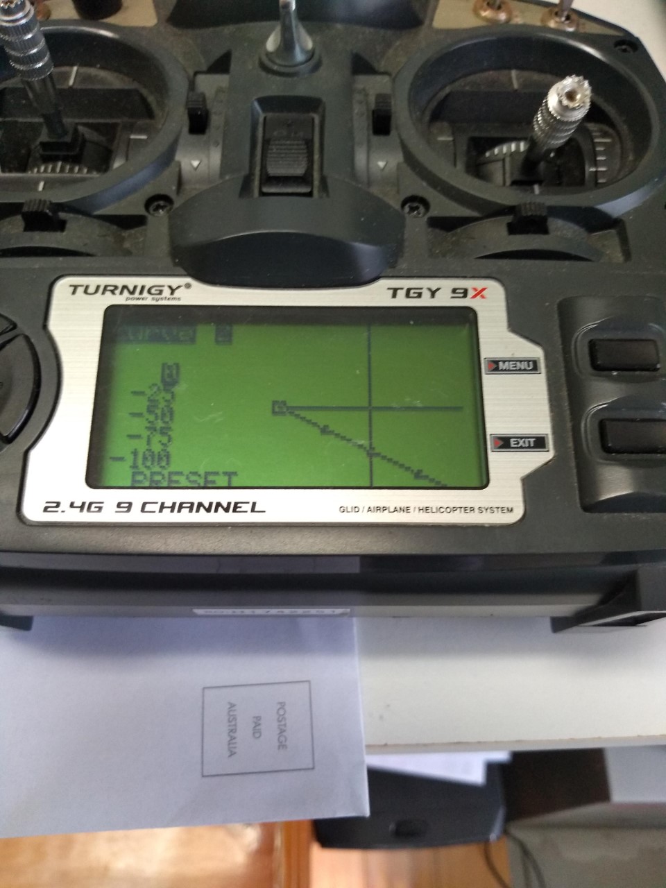

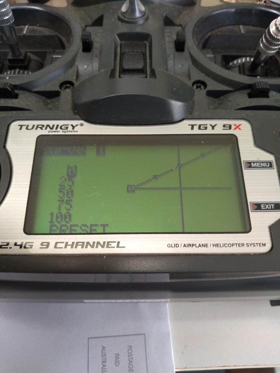

First I set 2 curves to take care of the stick movement for forward and reverse.

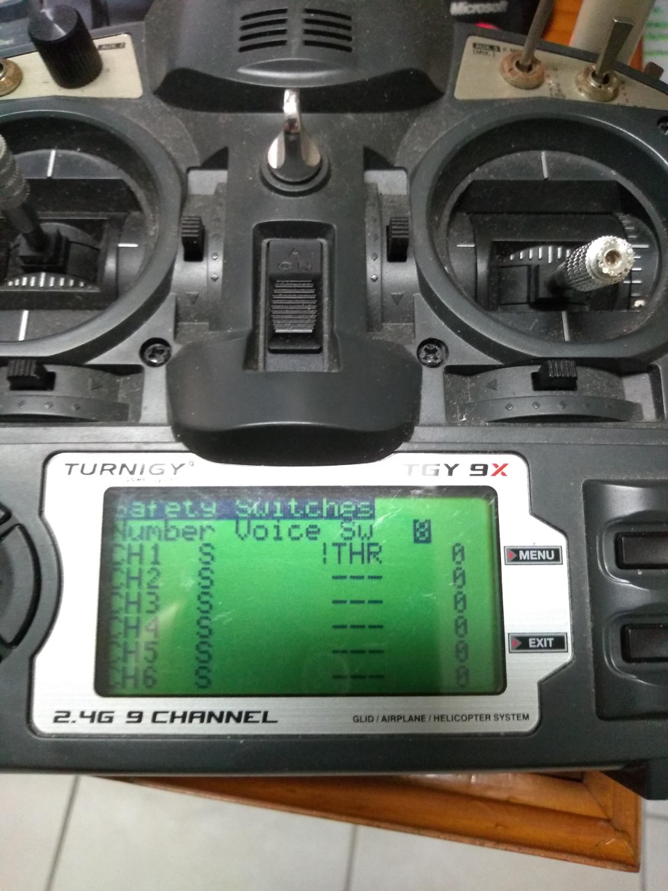

Then I set the safety switch on the throttle so no motor run could occur at startup.

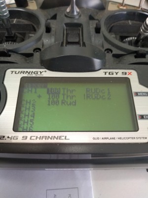

So, turn on, set safety switch forward position and with the rudder switch, select either forward or reverse motor run.
Throttle goes from zero speed to maximum in the selected direction.

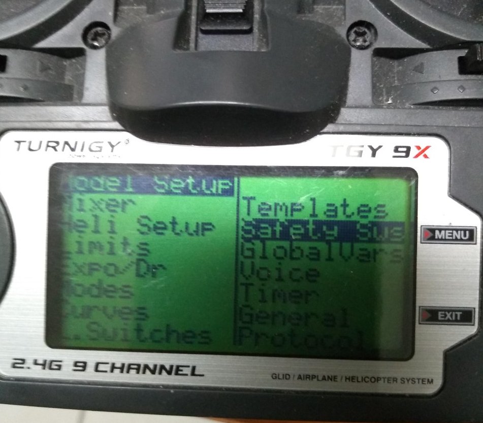

Also just found safety switch menu and set one up as throttle cut on radio turn on.

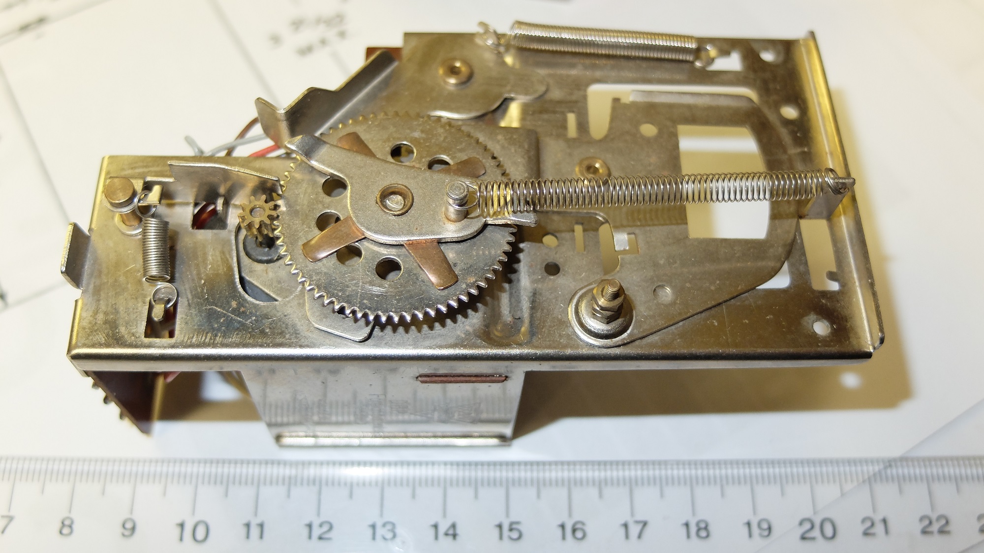

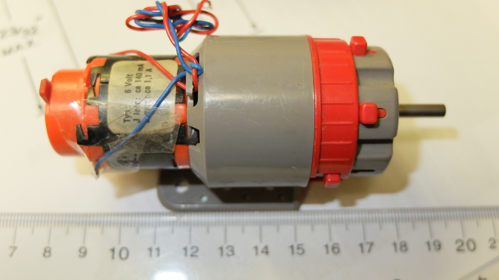

In a recent radio lot aqua-sition I came across this ingenious device which I believe was a collaboration between Rube Goldberg and Heath Robinson
(German Division) which would allow Forward - Stop- Reverse - Stop - Left- Center- Right -Center all off ONE button. How hard could that be?
I have tested the 6 speed Marx Richard gear motor that came with it to find that it works fine but have not tried out this gadget as yet - maybe today?
Test glides over long grass expected soon.

This actuator is the Graupner Kinematic. Designed for boat and car use but allegedly a modeller did manage to fly a plane with one in.

Thanks for the video link Shaun. Fascinating device.

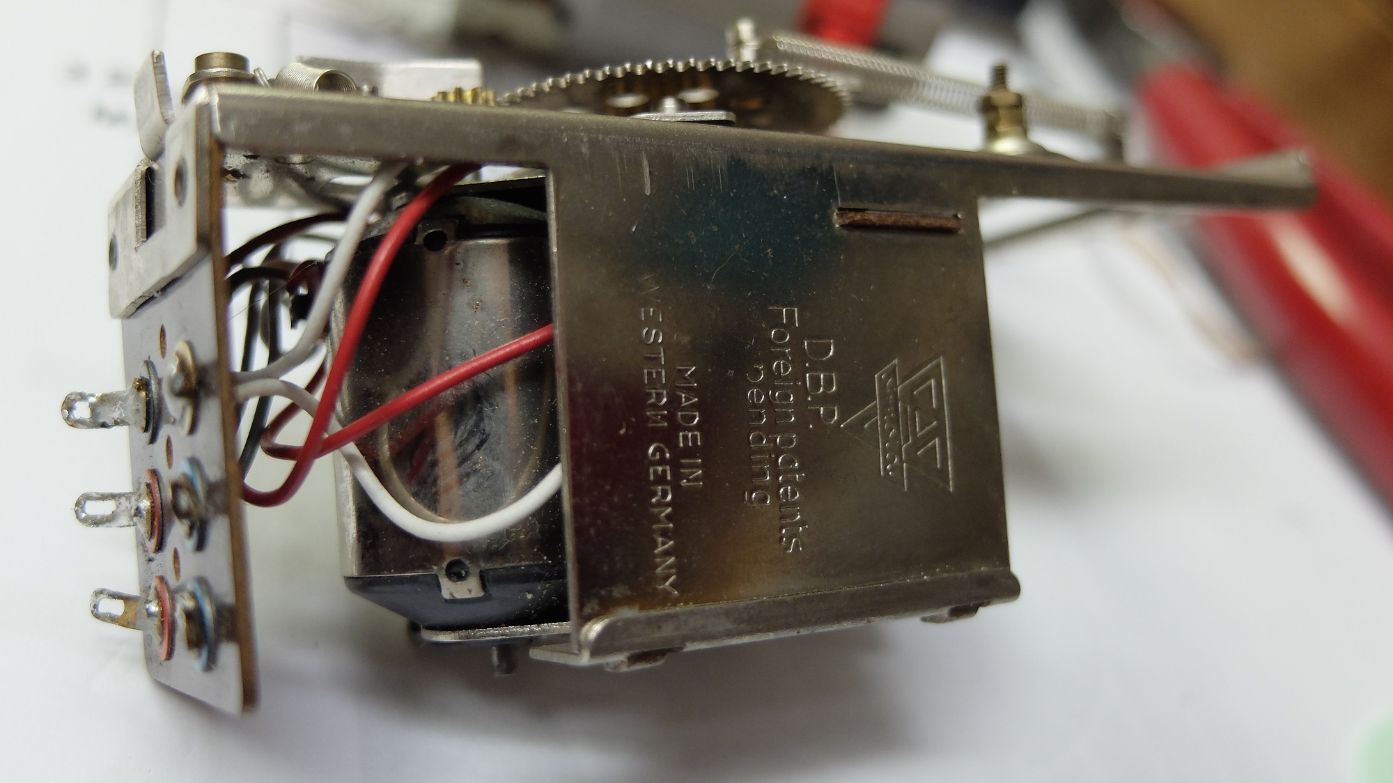

I did wire mine up this afternoon (only 2 PM here) using a push button instead of a radio and the Kinematic worked somewhat.
I used a 4.8V 4 cell standard flight pack for the Kinematic and a 2s Li-Fe to run the motor
It does not return to center as snappy as your example but I could get the FWD - Stop -Rev - stop motor functions
as well as left and right rudder. This has probably been sitting for many, many years before I got it
(with a new in box Futaba FT-3A radio and F327R receiver!!) I doubt if it has ever been installed in a boat or anything else.
