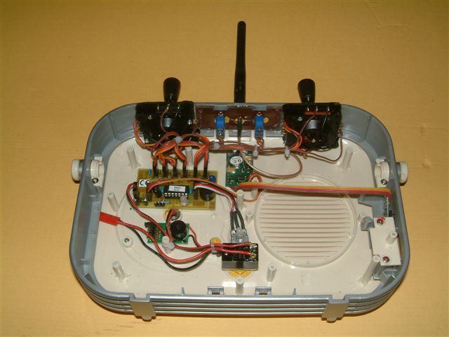

The transmitter is now complete and has been "smoke tested" successfully! I had to rethink my installation a bit, though:
Originally, I planned to put the encoder board in the empty right hand panel, mirroring the RF board, but it was just a fraction too wide! Instead, its gone under the aerial in the middle. This makes it more fiddly to plug and unplug things, but hopefully I won't need to do that often!
I've never handled a 10-channel Variophon before (mine is only 8), but there was a hole in the rear casing with a DIN plug behind it for charging. I don't know if this was standard, or whether it was done by a previous owner, but I had intended to put the "speed" pot behind it. Unfortunately, having to move the encoder has scuppered that idea, so I've put it in the battery compartment, as Frank suggested (more drilling seriously thick steel!).
At this point, I disconnected the RF board, and carries out a "smoke test" on the encoder, monitoring with a 'scope. Pulses appeared and appeared to move as expected, so next it was fire up the spectrum analyzer and check for RF output - YES! It was all there!

Pete, why not using a DIN-plug again as a charging jack for your batterie, you can even connect all ballancing wires to that plug for a full ballanced charge. I do that in some of my transmitters.
That charging plug was standard in the later series of Variophon tranies. The early models didn´t have it.

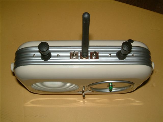

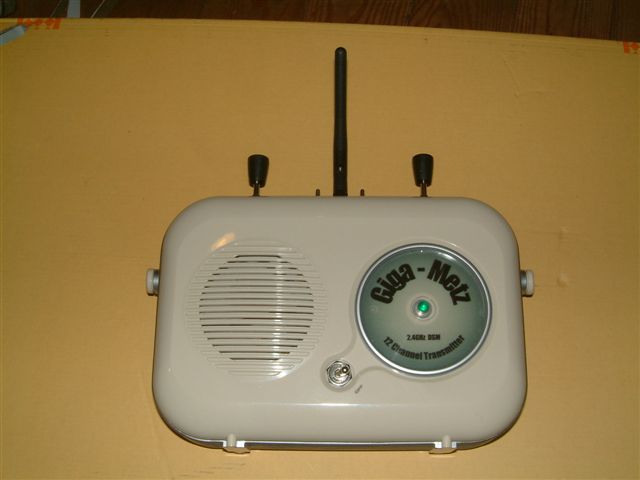

I do prefer the joystick type reed sets. As I couldn't find a suitable Tx to convert at the time( for sensible money) I used an FM retro radio Sainsburys had on offer for £15.00 and ripped out the guts. In fact it could qualify as a vintage set now as it used one of Phils early hand etched PCB's for the 10 channel reed encoder.

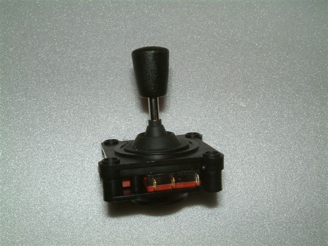

The micro switch stick units are superb and very well engineered, from memory only about £12.00 each.
I initially used a Corona Rf module but later converted it to Spektrum

Frank: I'll be using a 2S LiPo for power, and I don't like charging those in situ for safety reasons. I don't like using LiPos in transmitters, but I'm not convinced a 2S LiFe would have enough headroom for the voltage regulators.
Shaun: Yes, I remember your faux Metz! Where did you get those switches from? I ought to get a set to play with....

In my experience a 2S LiFe is more than adequate for either a FrSky or OrangeRx hack modules and an Arduino as well. Both the FrSky and OrangeRx are rated for 6V minimum, use LDO or switched regulators and all their circuitry is 3V3 so plenty of headroom. And every Arduino I've tested has happily worked to well below 5V on the Vin pin. They also use LDO regulators, so at 5V have around 4.3V going to the ATmega328 and the data sheet has the minimum voltage as 4.2V @ 16MHz (from memory), so you are within specs.
The minimum for a 2S LiFe is 5V, but similar to a lipo, you don't really want to go to the minimum, so 6V minimum is sensible. Therefore it seems a good match to me and it is what I've used in a few 2.4GHz conversions without problem. I charge them in-situ via the balance lead and a 6-pin DIN 5/180°connector that I don't use for any other application and also have a dedicated charger for LiFe batteries with the same connector (I use a different 6 pin DIN for Lipo's so I can't accidentally charge the wrong type).

ps some of my other Variophons have the DIN connector fitted in the same place as your's, so I think it may have been fitted in the factory. But then again, I got 7 of them from the same person (selling his late Fathers estate), so it may have been a personal modification. Maybe Frank knows if they came from the factory with DIN connectors?

Yes, they came from the factory with the charging plug, but only the later models. The early models did not have it. I have five of them, one 4channel, one 8channel and three 10channel sets. Only one of the 10channel sets is equipped with the mentioned charging plug and its the newest one I have.
But it´s not a DIN charging plug as we know them now, it was a special Grundig version of it. The oulines are exactly as the modern DIN plugs, but the pins are a little different. Since the oulines are the same, you can easily replace them by a modern 5 or 7 pin DIN plug for ballance charging.
BTW its the same charging plug as the later Grundig TX14 and all the Varioprop propo sets had, so it was factory installed for sure.

I seem to remember getting the switch units from Farnell. They are excellent quality and have a great feel, just enough resistance but not like car window switches .

Thanks all for the comments and info! The Tx is now complete - except for some minor cosmetic work - and the battery installed (a 2S LiPo).
Mike_K: thanks for the info on the regulators. I know LiFes normally sit around 6.6V on load, which *should* be enough headroom, but I wasn't sure. I do use 2S packs for some receiver installations, and 3S packs in 9.8V transmitters.
