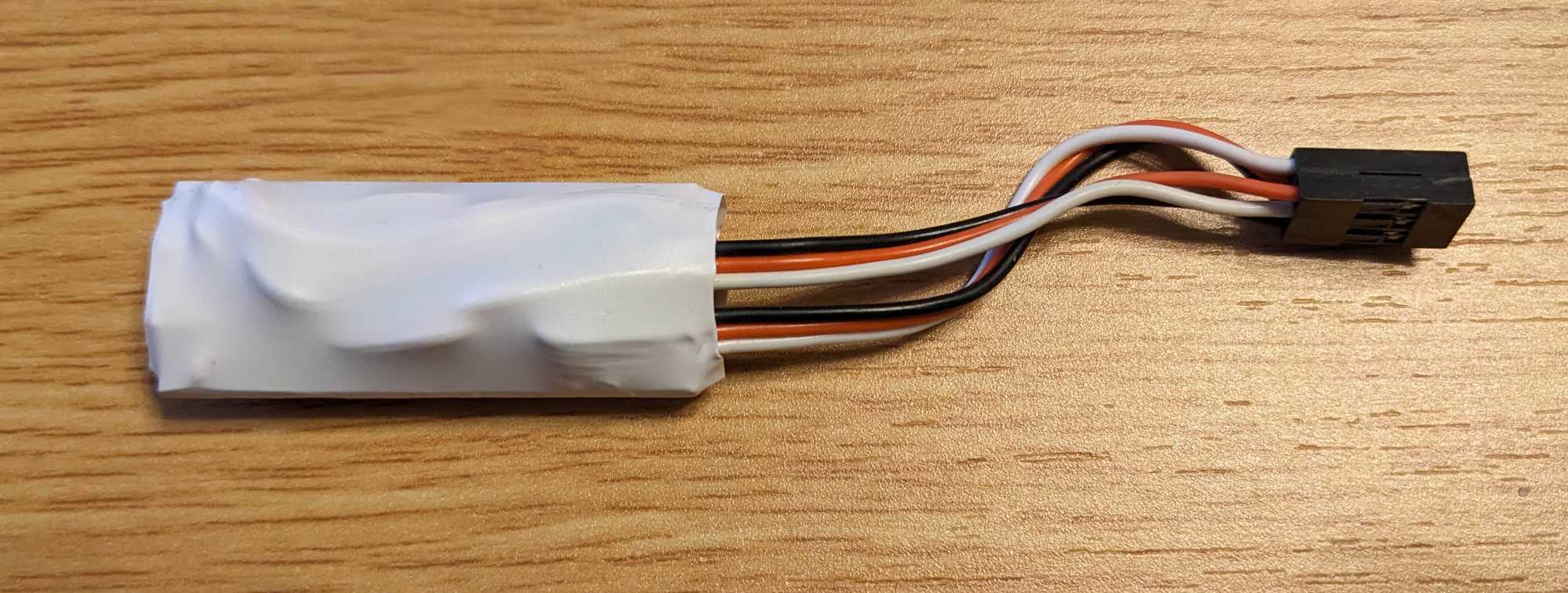

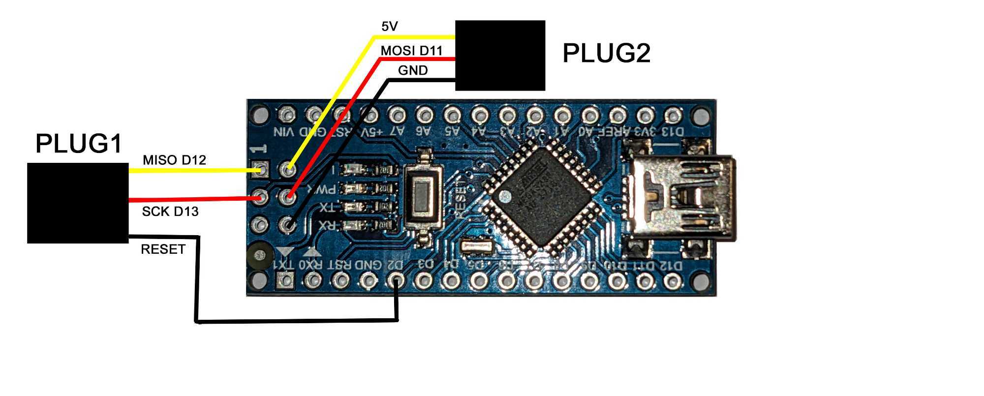

Instead of using a Uno, I've made all of mine using a Nano with the "6-pin lead" made from two servo leads/plugs glued together with Cyano. You need a Nano with the header pins NOT soldered (they often get supplied with the headers already soldered).
I have not soldered the leads into the normal D11, D12, D13, 5V or GND pins, but used the Nano ISP header as it has duplicates of those connections. The only one not connected to the normal pins is the target RESET pin that is connected to D2 pin (the official instructions has it connected to D10, but I altered one line of the code to be D2 as the D2 pin is closer to the other connections I'm using to keep the wiring tidier). You can program the Nano either via its USB connector or if you already have an ICSP programmer, you can program it by temporarily using a 6-pin header in the icsp connections.
Note:
when building the programmer, you use 'Upload' to get the programmer sketch into the Nano.
when using the completed programmer, you use 'Upload Using Programmer' otherwise your new programmer itself will become an encoder!

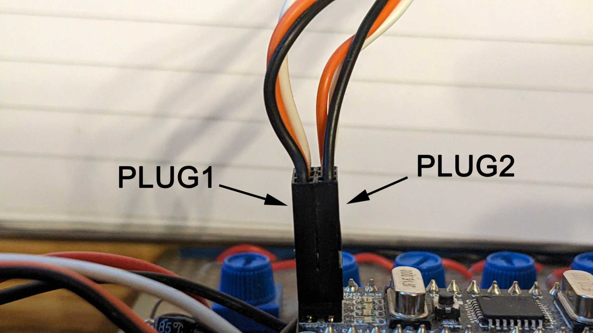

Wiring (see optional 'colours' comment in following post)

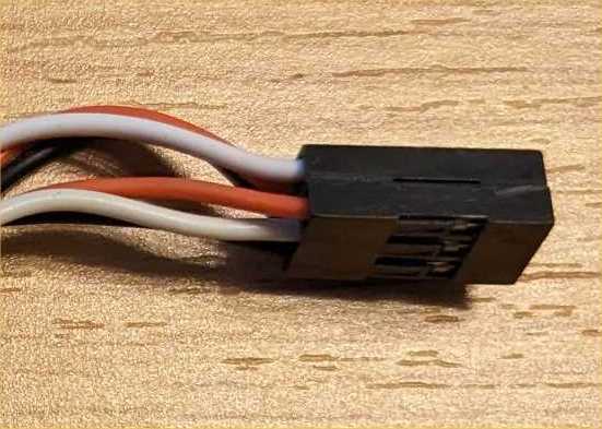

Using one 'Futaba' black/red/white lead and for the other one a 'JR' brown/red/orange helps orient the assembled plug.
When glueing the plugs together you must get them the correct way around!
ie both Futaba blacks at the same end, or Futaba black and JR brown at one end:
Then I heat-shrink the Arduino Nano

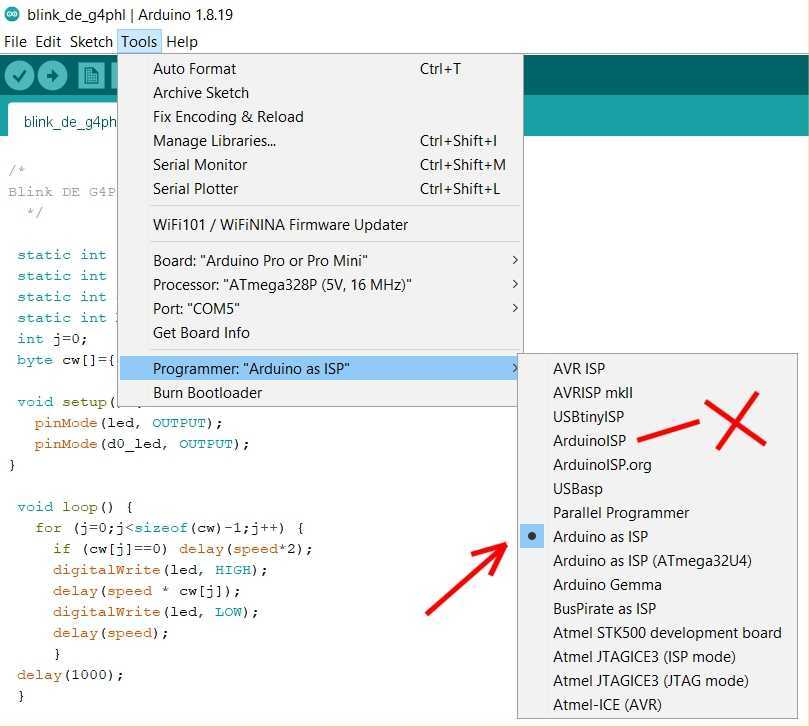

Another potential 'gotcha' is correctly selecting the programmer as "Arduino as ISP" and not "Arduino ISP"
As with a usbasp, use "Upload Using Programmer" not "Upload". Otherwise "Upload" will program the programmer itself with your sketch!

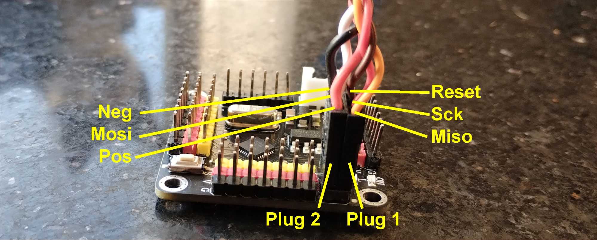

Yes Phil, I do swap the servo wires so red is +5V and the white is MOSI, but explaining that in my instructions was too difficult, so I didn't. Trust you to have noticed!Phil_G wrote: 01 Nov 2024, 13:45 As I was doing 'plug 2' (pos, mosi, gnd) I thought I'd swap the red & white in the servo plug and on the Nano connections, to make it more logical - so red & black were pos & neg on the ICSP header and white was mosi. Then I noticed that I think Mike did the same!

Re: Simple USBASP alternative - Arduino as ISP

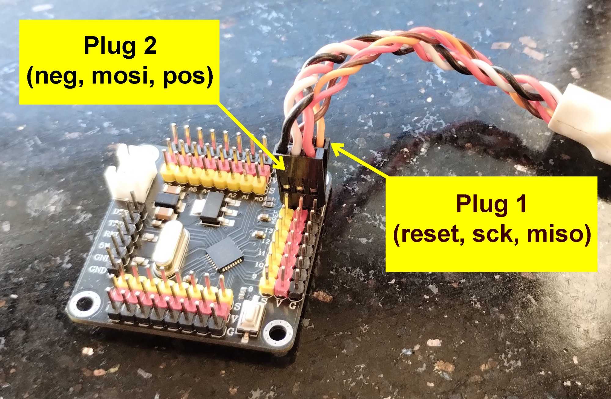

Some more pictures. You'll see that on Plug2 we swapped the pos & mosi colours at the plug end and also at the Nano end.
Electrically, provided you swap both ends, it makes no difference, its just colours.

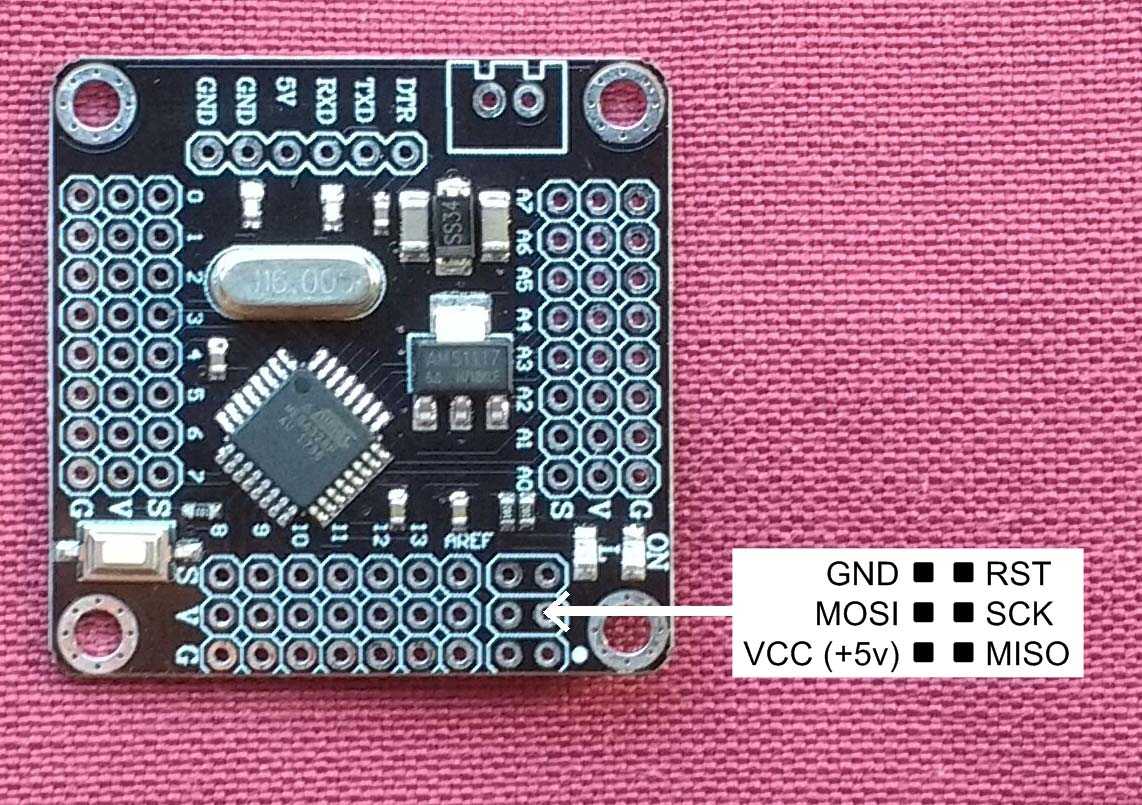

I have fried several boards trying to use a USBASP programmer that it says uses 3.3 volt I/O lines but doesn't.
Sparkfun appears to no longer list a USBASP programmer.
Does this board solution support 3.3 and 5 volt boards? Or does it provide 5 volts and depends on the device to use an onboard 3.3 volt regulator?
Thanks
Thanks
Nothing like the smell of Nitro in the morning.
- Flynn
- Posts: 95
- Joined: 17 Feb 2018, 14:48
Re: Simple, reliable alternative to USBASP programmer - Arduino as ISP
AS the target board that board supports 5v on the ICSP port as denoted on the silk screen on the board. If you are intending on using this board as the ICSP programmer then it will output 5v because the uP is a 5v version and there is no 3v3 regulator on the board. You would need a bi-directional 3v3 to 5v level changer to drop the 5v signal to 3v3......or you could use a 3v3 Arduino micro...but then you will need a USBASP to program it

I've now made 5 or 6 Arduino as ISP and the one that didn't work was because I glued the servo connectors reversed, so double check you have the wiring correct.
Finally, I'd suggest buying an usbasp and try that first, then if that doesn't work then try the Arduino as ISP. usbasp work for 90% of people, the Arduino as ISP seems to work for 99% of people if constructed properly
